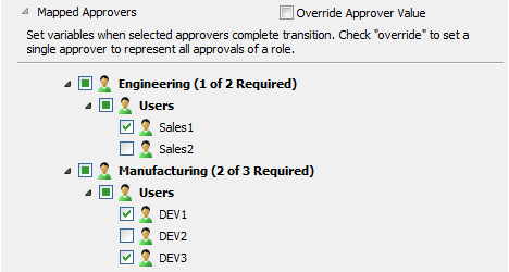

An enhanced Set Variable transition action dialog box lets administrators select users from various roles to capture data from. There is also an override that lets you capture data from a specific user irrespective of users who actually transitioned the file.

- Select the Variable and enter the Value.
- Expand Mapped Approvers and select approvers.
- Click OK twice.
- Save the workflow.
If you select Override Approver Value, radio buttons replace check boxes, and you can select only one user.
