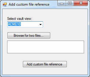

// Postconditions:
// 1. Displays the Add custom file reference dialog box.
//    a. Select a vault view.
//    b. Click Browse for two files
//       1. Locate and click two files in the root folder of the vault.
//       2. Click Open.
//          The first file is checked out.
//    c. Click Add custom file reference.
//       Displays a message box confirming that the second file is added as a
//       custom reference to the first file.
//    d. Click OK.
//       Displays a message box with all of the custom file references of the first
//       file.
//    e. Click OK.
// 6. Close the Add custom file reference dialog.

        private void InitializeComponent()
            this.VaultsLabel = new System.Windows.Forms.Label();
            this.VaultsComboBox = new System.Windows.Forms.ComboBox();
            this.BrowseButton = new System.Windows.Forms.Button();
            this.CustRefListBox = new System.Windows.Forms.ListBox();
            this.AddCustomFileReference = new System.Windows.Forms.Button();
            this.CustRefOpenFileDialog = new System.Windows.Forms.OpenFileDialog();
            this.SuspendLayout();
            //VaultsLabel
            this.VaultsLabel.AutoSize = true;
            this.VaultsLabel.Location = new System.Drawing.Point(13, 26);
            this.VaultsLabel.Name = "VaultsLabel";
            this.VaultsLabel.Size = new System.Drawing.Size(91, 13);
            this.VaultsLabel.TabIndex = 0;
            this.VaultsLabel.Text = "Select vault view:";
            //VaultsComboBox
            this.VaultsComboBox.FormattingEnabled = true;
            this.VaultsComboBox.Location = new System.Drawing.Point(16, 42);
            this.VaultsComboBox.Name = "VaultsComboBox";
            this.VaultsComboBox.Size = new System.Drawing.Size(121, 21);
            this.VaultsComboBox.TabIndex = 1;
            //BrowseButton
            this.BrowseButton.Location = new System.Drawing.Point(16, 78);
            this.BrowseButton.Name = "BrowseButton";
            this.BrowseButton.Size = new System.Drawing.Size(146, 23);
            this.BrowseButton.TabIndex = 3;
            this.BrowseButton.Text = "Browse for two files...";
            this.BrowseButton.UseVisualStyleBackColor = true;
            this.BrowseButton.Click +=new System.EventHandler(BrowseButton_Click);
            //CustRefListBox
            this.CustRefListBox.FormattingEnabled = true;
            this.CustRefListBox.HorizontalScrollbar = true;
            this.CustRefListBox.Location = new System.Drawing.Point(16, 107);
            this.CustRefListBox.Name = "CustRefListBox";
            this.CustRefListBox.SelectionMode = System.Windows.Forms.SelectionMode.MultiExtended;
            this.CustRefListBox.Size = new System.Drawing.Size(259, 56);
            this.CustRefListBox.TabIndex = 4;
            //AddCustomFileReference
            this.AddCustomFileReference.Location = new System.Drawing.Point(68, 175);
            this.AddCustomFileReference.Name = "AddCustomFileReference";
            this.AddCustomFileReference.Size = new System.Drawing.Size(150, 23);
            this.AddCustomFileReference.TabIndex = 5;
            this.AddCustomFileReference.Text = "Add custom file reference";
            this.AddCustomFileReference.UseVisualStyleBackColor = true;
            this.AddCustomFileReference.Click +=new System.EventHandler(AddCustomFileReference_Click);
            //CustRefOpenFileDialog
            this.CustRefOpenFileDialog.Multiselect = true;
            //Form1
            this.AutoScaleDimensions = new System.Drawing.SizeF(6f, 13f);
            this.AutoScaleMode = System.Windows.Forms.AutoScaleMode.Font;
            this.ClientSize = new System.Drawing.Size(287, 222);
            this.Controls.Add(this.AddCustomFileReference);
            this.Controls.Add(this.CustRefListBox);
            this.Controls.Add(this.BrowseButton);
            this.Controls.Add(this.VaultsComboBox);
            this.Controls.Add(this.VaultsLabel);
            this.Name = "Form1";
            this.Text = "Add custom file reference";
            this.Load += new System.EventHandler(this.Form1_Load);
            this.ResumeLayout(false);
            this.PerformLayout();
        #endregion
        internal System.Windows.Forms.Label VaultsLabel;
        internal System.Windows.Forms.ComboBox VaultsComboBox;
        internal System.Windows.Forms.Button BrowseButton;
        internal System.Windows.Forms.ListBox CustRefListBox;
        internal System.Windows.Forms.Button AddCustomFileReference;
        internal System.Windows.Forms.OpenFileDialog CustRefOpenFileDialog;
