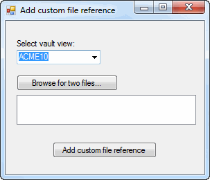

' Postconditions:
' 1. Displays the Add custom file reference dialog box.
' a. Select a vault view.
' b. Click Browse for two
files.
' 1. Locate and click two files in the root
folder of the vault.
' 2. Click Open.
' The
first file is checked out.
' c. Click Add custom file reference.
' Displays a message
box confirming that the second file is added as a
' custom reference to the first file.
' d. Click OK.
' Displays a message box with all of the
custom file references of the first
' file.
' e. Click OK.
' 2. Close the Add custom file reference dialog.

'CustRefOpenFileDialog
Me.CustRefOpenFileDialog.Multiselect = True
'Form1
Me.AutoScaleDimensions = New System.Drawing.SizeF(6.0!, 13.0!)
Me.AutoScaleMode = System.Windows.Forms.AutoScaleMode.Font
Me.ClientSize = New System.Drawing.Size(287, 222)
Me.Controls.Add(Me.AddCustomFileReference)
Me.Controls.Add(Me.CustRefListBox)
Me.Controls.Add(Me.BrowseButton)
Me.Controls.Add(Me.VaultsComboBox)
Me.Controls.Add(Me.VaultsLabel)
Me.Name = "Form1"
Me.Text = "Add custom file reference"
Me.ResumeLayout(False)
Me.PerformLayout()
