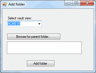

// Postconditions:
// 1. Displays the Add folder dialog box.
//    a. Select a vault view.
//    b. Click Browse for parent folder
//       1. Locate and click a folder in the vault.
//       2. Click OK.
//    c. Click Add folder.

            this.VaultsLabel.Text = " Select vault view:";
            //VaultsComboBox
            this.VaultsComboBox.FormattingEnabled = true;
            this.VaultsComboBox.Location = new System.Drawing.Point(16, 42);
            this.VaultsComboBox.Name = "VaultsComboBox";
            this.VaultsComboBox.Size = new System.Drawing.Size(121, 21);
            this.VaultsComboBox.TabIndex = 1;
            //BrowseButton
            this.BrowseButton.Location = new System.Drawing.Point(16, 85);
            this.BrowseButton.Name = "BrowseButton";
            this.BrowseButton.Size = new System.Drawing.Size(186, 23);
            this.BrowseButton.TabIndex = 3;
            this.BrowseButton.Text = "Browse for parent folder...";
