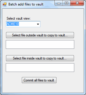

//  5. Click Debug > Start Debugging or press F5.
// Postconditions:
//  1. The Batch add files to vault dialog box displays.
//     a. Select a vault view.
//     b. Click Select file outside vault to copy to vault.
//     c. In the Select File dialog:
//        1. Click a file outside the vault.
//        2. Click Open.
//     d. Click Select file inside vault to copy to vault.
//     e. In the Select File dialog:
//        1. Click a file in the vault.
//        2. Click Open.
//     f. Click Commit all files to vault.
//  2. Click Add in the Batch Items dialog box.
//  3. Click OK to close the message box.
//     Two new folders, Folder1 and Folder2, are created in the vault's
//     root directory. The first selected file is copied to Folder1.
//     The second selected file is copied to Folder2.
//  4. Close the Batch add files to vault dialog box.

        private void InitializeComponent()
            this.VaultsLabel = new System.Windows.Forms.Label();
            this.VaultsComboBox = new System.Windows.Forms.ComboBox();
            this.BatchAdd = new System.Windows.Forms.Button();
            this.CopyToVault = new System.Windows.Forms.Button();
            this.FileList1 = new System.Windows.Forms.ListBox();
            this.CopyFromVault = new System.Windows.Forms.Button();
            this.FileList2 = new System.Windows.Forms.ListBox();
            this.SelectFileDialog = new System.Windows.Forms.OpenFileDialog();
            this.SuspendLayout();
            //VaultsLabel
            this.VaultsLabel.AutoSize = true;
            this.VaultsLabel.Location = new System.Drawing.Point(12, 27);
            this.VaultsLabel.Name = "VaultsLabel";
            this.VaultsLabel.Size = new System.Drawing.Size(91, 13);
            this.VaultsLabel.TabIndex = 0;
            this.VaultsLabel.Text = "Select vault view:";
            //VaultsComboBox
            this.VaultsComboBox.FormattingEnabled = true;
            this.VaultsComboBox.Location = new System.Drawing.Point(12, 43);
            this.VaultsComboBox.Name = "VaultsComboBox";
            this.VaultsComboBox.Size = new System.Drawing.Size(121, 21);
            this.VaultsComboBox.TabIndex = 1;
            //BatchAdd
            this.BatchAdd.Location = new System.Drawing.Point(67, 236);
            this.BatchAdd.Name = "BatchAdd";
            this.BatchAdd.Size = new System.Drawing.Size(123, 23);
            this.BatchAdd.TabIndex = 2;
            this.BatchAdd.Text = "Commit all files to vault";
            this.BatchAdd.UseVisualStyleBackColor = true;
            this.BatchAdd.Click += new System.EventHandler(this.BatchAdd_Click);
            //CopyToVault
            this.CopyToVault.Location = new System.Drawing.Point(12, 80);
            this.CopyToVault.Name = "CopyToVault";
            this.CopyToVault.Size = new System.Drawing.Size(239, 23);
            this.CopyToVault.TabIndex = 3;
            this.CopyToVault.Text = "Select file outside vault to copy to vault...";
            this.CopyToVault.UseVisualStyleBackColor = true;
            this.CopyToVault.Click += new System.EventHandler(this.CopyToVault_Click);
            //FileList1
            this.FileList1.FormattingEnabled = true;
            this.FileList1.Location = new System.Drawing.Point(12, 109);
            this.FileList1.Name = "FileList1";
            this.FileList1.Size = new System.Drawing.Size(239, 30);
            this.FileList1.TabIndex = 4;
            //CopyFromVault
            this.CopyFromVault.Location = new System.Drawing.Point(12, 160);
            this.CopyFromVault.Name = "CopyFromVault";
            this.CopyFromVault.Size = new System.Drawing.Size(239, 23);
            this.CopyFromVault.TabIndex = 5;
            this.CopyFromVault.Text = "Select file inside vault to copy to vault...";
            this.CopyFromVault.UseVisualStyleBackColor = true;
            this.CopyFromVault.Click += new System.EventHandler(this.CopyFromVault_Click);
            //FileList2
            this.FileList2.FormattingEnabled = true;
            this.FileList2.Location = new System.Drawing.Point(12, 189);
            this.FileList2.Name = "FileList2";
            this.FileList2.Size = new System.Drawing.Size(239, 30);
            this.FileList2.TabIndex = 6;
            //SelectFileDialog
            this.SelectFileDialog.Title = "Select File";
            //Form1
            this.AutoScaleDimensions = new System.Drawing.SizeF(6f, 13f);
            this.AutoScaleMode = System.Windows.Forms.AutoScaleMode.Font;
            this.ClientSize = new System.Drawing.Size(284, 291);
            this.Controls.Add(this.FileList2);
            this.Controls.Add(this.CopyFromVault);
            this.Controls.Add(this.FileList1);
            this.Controls.Add(this.CopyToVault);
            this.Controls.Add(this.BatchAdd);
            this.Controls.Add(this.VaultsComboBox);
            this.Controls.Add(this.VaultsLabel);
            this.Name = "Form1";
            this.Text = "Batch add files to vault";
            this.Load += new System.EventHandler(this.Form1_Load);
            this.ResumeLayout(false);
            this.PerformLayout();
        #endregion
