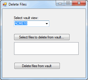

' Postconditions:
' 1. The Delete Files dialog box displays.
' a. Select a vault view.
' b. Click Select files
to delete from vault.
' c. In the Select File dialog:
' 1. Click a file
inside the vault.
' 2. Click Open.
' d. Click Delete
files from vault.
' 2. Click Delete in the Confirm Multiple File Delete dialog box.

Me.VaultsLabel = New System.Windows.Forms.Label()
Me.VaultsComboBox = New System.Windows.Forms.ComboBox()
Me.SelectFiles = New System.Windows.Forms.Button()
Me.File1List = New System.Windows.Forms.ListBox()
Me.BatchDelete = New System.Windows.Forms.Button()
Me.OpenFileDialog1 = New System.Windows.Forms.OpenFileDialog()
Me.SuspendLayout()
'VaultsLabel
Me.VaultsLabel.AutoSize = True
Me.VaultsLabel.Location = New System.Drawing.Point(36, 24)
Me.VaultsLabel.Name = "VaultsLabel"
Me.VaultsLabel.Size = New System.Drawing.Size(91, 13)
Me.VaultsLabel.TabIndex = 0
Me.VaultsLabel.Text = "Select vault view:"
'VaultsComboBox
Me.VaultsComboBox.FormattingEnabled = True
Me.VaultsComboBox.Location = New System.Drawing.Point(39, 40)
Me.VaultsComboBox.Name = "VaultsComboBox"
Me.VaultsComboBox.Size = New System.Drawing.Size(121, 21)
Me.VaultsComboBox.TabIndex = 1
'SelectFiles
Me.SelectFiles.Location = New System.Drawing.Point(39, 85)
Me.SelectFiles.Name = "SelectFiles"
Me.SelectFiles.Size = New System.Drawing.Size(191, 23)
Me.SelectFiles.TabIndex = 2
Me.SelectFiles.Text = "Select files to delete from vault..."
Me.SelectFiles.UseVisualStyleBackColor = True
'File1List
Me.File1List.FormattingEnabled = True
Me.File1List.HorizontalScrollbar = True
Me.File1List.Location = New System.Drawing.Point(40, 114)
Me.File1List.Name = "File1List"
Me.File1List.SelectionMode = System.Windows.Forms.SelectionMode.MultiExtended
Me.File1List.Size = New System.Drawing.Size(220, 43)
Me.File1List.TabIndex = 4
'BatchDelete
Me.BatchDelete.Location = New System.Drawing.Point(40, 183)
Me.BatchDelete.Name = "BatchDelete"
Me.BatchDelete.Size = New System.Drawing.Size(157, 23)
Me.BatchDelete.TabIndex = 6
Me.BatchDelete.Text = "Delete files from vault"
Me.BatchDelete.UseVisualStyleBackColor = True
'OpenFileDialog1
Me.OpenFileDialog1.FileName = "OpenFileDialog1"
Me.OpenFileDialog1.Multiselect = True
Me.OpenFileDialog1.Title = "Select File"
'Form1
Me.AutoScaleDimensions = New System.Drawing.SizeF(6.0!, 13.0!)
Me.AutoScaleMode = System.Windows.Forms.AutoScaleMode.Font
Me.ClientSize = New System.Drawing.Size(284, 235)
Me.Controls.Add(Me.BatchDelete)
Me.Controls.Add(Me.File1List)
Me.Controls.Add(Me.SelectFiles)
Me.Controls.Add(Me.VaultsComboBox)
Me.Controls.Add(Me.VaultsLabel)
Me.Name = "Form1"
Me.Text = "Delete Files"
Me.ResumeLayout(False)
Me.PerformLayout()
End Sub
