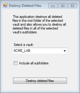

This example shows how to create an application that displays a form in which a user can select the vault in whose root folder and subfolders all deleted files will be permanently destroyed. The user must have permission to delete files.

'  6. Create a form similar to the form shown above and change:
'     a. Second label to VaultsLabel.
'     b. Combo box to VaultsComboBox.
'     c. Check box to CheckBox_Recursive.
'     d. Button to DestroyDeletedItemsButton.

' Postconditions:
'  1. Displays the Destroy Deleted Files dialog.
'  2. Select a vault.
'  3. Optionally select the Include all subfolders check box.
'  4. Click the Destroy deleted files button.
'     A message box pops up informing you that:
'     * No deleted files were found to destroy.
'       - or -
'     * The deleted files were destroyed.
'  5. Click OK in the message box.
'  6. Close the Destroy Deleted Files dialog.
