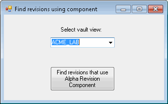

//  6. Create a form similar to the form shown above and change:
//     a. Label to VaultsLabel.
//     b. Combo box to VaultsComboBox
//     c. Button to FindRevisionsButton.
//  7. Replace the code in Form1.cs with this code.

//  1. Displays a dialog.
//  2. Select a vault.
//  3. Click the Find revisions that use Alpha Revision Component button.
//  4. Prints the names of the revision numbers using the revision number
//     component Alpha Revision Component to the Immediate window.
//  5. Examine the Immediate window.
//  6. Close the dialog.

            this.VaultsLabel = new System.Windows.Forms.Label();
            this.VaultsComboBox = new System.Windows.Forms.ComboBox();
            this.FindRevisionsButton = new System.Windows.Forms.Button();
            this.SuspendLayout();
            // VaultsLabel
            this.VaultsLabel.AutoSize = true;
            this.VaultsLabel.Location = new System.Drawing.Point(112, 37);
            this.VaultsLabel.Name = "VaultsLabel";
            this.VaultsLabel.Size = new System.Drawing.Size(91, 13);
            this.VaultsLabel.TabIndex = 0;
            this.VaultsLabel.Text = "Select vault view:";
            // VaultsComboBox
            this.VaultsComboBox.FormattingEnabled = true;
            this.VaultsComboBox.Location = new System.Drawing.Point(94, 77);
            this.VaultsComboBox.Name = "VaultsComboBox";
            this.VaultsComboBox.Size = new System.Drawing.Size(121, 21);
            this.VaultsComboBox.TabIndex = 1;
            // FindRevisionsButton
            this.FindRevisionsButton.Location = new System.Drawing.Point(94, 136);
            this.FindRevisionsButton.Name = "FindRevisionsButton";
            this.FindRevisionsButton.Size = new System.Drawing.Size(121, 50);
            this.FindRevisionsButton.TabIndex = 2;
            this.FindRevisionsButton.Text = "Find revisions that use Alpha Revision Component";
            this.FindRevisionsButton.UseVisualStyleBackColor = true;
            this.FindRevisionsButton.Click += new System.EventHandler(this.FindRevisionsButton_Click);
