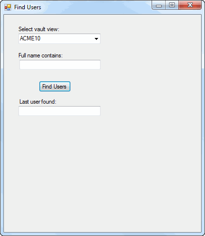

Find Users Example (C#)
This example shows how to find users in the
vault.
NOTE: If using the .NET Framework 4.0 primary interop assembly
provided with SOLIDWORKS Enterprise PDM, see
Using .NET Framework 4.0 in
Stand-alone Applications.
// Preconditions:
// 1. Start Microsoft Visual Studio 2010.
// a. Click File > New > Project > Visual C# > Windows Forms Application.
// b. Type FindUser_CSharp in Name.
// c. Click Browse and navigate to the folder where to create the project.
// d. Click OK.
// e. Click Show All Files in the Solution Explorer toolbar and expand
// Form1.cs in the Solution Explorer.
// f. Replace the code in Form1.cs with this code.
// g. To create the form, replace the code in Form1.Designer.cs with
// this code.
// 2. Add EPDM.Interop.epdm.dll as a reference (right-click the project
// name in the Solution Explorer, click Add Reference, click
// Assemblies > Framework in the left-side panel, browse to the top folder of
// your SOLIDWORKS Enterprise PDM installation, locate and click
// EPDM.Interop.epdm.dll, click Open, and click Add).
// 3. Add Microsoft.VisualBasic as a reference (click COM in the left-side panel,
// click Microsoft.VisualBasic, click Add, and click Close).
// 4. Right-click EPDM.Interop.epdm in References, click Properties, and set
// Embed Interop Types to False to handle methods that pass arrays of
// structures.
// 5. Click Debug > Start Debugging or press F5.
// Postconditions:
// 1. Displays the
Find Users dialog box.
// a. Select a vault
view.
// b. In
Full name contains, type a substring of the full name of a
user that exists in the vault.
// c. Click
Find Users.
A message box confirms the substring typed in Postconditions
step 1b.
d. Click OK.
Displays a Search for users dialog.
e. Click Find.
Displays a Search for users dialog with results.
f. Click the first row.
g. Click Select.
* Displays a message box with the updated user information.
* The selected user's phone and website information are updated.
h. Click OK.
2. Updates the Find Users dialog box with the full name and picture,
// if it exists, of the last user found whose full name contains the substring
typed in Postconditions step 1b.
// 3. Close the Find
Users dialog box.

namespace FindUser_CSharp
partial class Form1
/// <summary>
/// Required designer variable.
/// </summary>
private System.ComponentModel.IContainer components = null;
/// <summary>
/// Clean up any resources being used.
/// </summary>
/// <param name="disposing">true if managed resources should be disposed; otherwise, false.</param>
protected override void Dispose(bool disposing)
if (disposing && (components != null))
components.Dispose();
base.Dispose(disposing);
#region Windows Form Designer generated code
/// <summary>
/// Required method for Designer support - do not modify
/// the contents of this method with the code editor.
/// </summary>
private void InitializeComponent()
this.FindUsers = new System.Windows.Forms.Button();
this.VaultsComboBox = new System.Windows.Forms.ComboBox();
this.Label1 = new System.Windows.Forms.Label();
this.Label2 = new System.Windows.Forms.Label();
this.TextBox1 = new System.Windows.Forms.TextBox();
this.Label3 = new System.Windows.Forms.Label();
this.TextBox2 = new System.Windows.Forms.TextBox();
this.SuspendLayout();
// FindUsers
this.FindUsers.Location = new System.Drawing.Point(72, 136);
this.FindUsers.Name = "FindUsers";
this.FindUsers.Size = new System.Drawing.Size(66, 23);
this.FindUsers.TabIndex = 0;
this.FindUsers.Text = "Find Users";
this.FindUsers.TextAlign = System.Drawing.ContentAlignment.MiddleLeft;
this.FindUsers.UseVisualStyleBackColor = true;
this.FindUsers.Click += new System.EventHandler(this.FindUsers_Click);
// VaultsComboBox
this.VaultsComboBox.FormattingEnabled = true;
this.VaultsComboBox.Location = new System.Drawing.Point(30, 39);
this.VaultsComboBox.Name = "VaultsComboBox";
this.VaultsComboBox.Size = new System.Drawing.Size(169, 21);
this.VaultsComboBox.TabIndex = 1;
// Label1
this.Label1.AutoSize = true;
this.Label1.Location = new System.Drawing.Point(27, 23);
this.Label1.Name = "Label1";
this.Label1.Size = new System.Drawing.Size(91, 13);
this.Label1.TabIndex = 2;
this.Label1.Text = "Select vault view:";
// Label2
this.Label2.AutoSize = true;
this.Label2.Location = new System.Drawing.Point(27, 77);
this.Label2.Name = "Label2";
this.Label2.Size = new System.Drawing.Size(98, 13);
this.Label2.TabIndex = 3;
this.Label2.Text = "Full name contains:";
// TextBox1
this.TextBox1.Location = new System.Drawing.Point(32, 93);
this.TextBox1.Name = "TextBox1";
this.TextBox1.Size = new System.Drawing.Size(167, 20);
this.TextBox1.TabIndex = 4;
// Label3
this.Label3.AutoSize = true;
this.Label3.Location = new System.Drawing.Point(29, 172);
this.Label3.Name = "Label3";
this.Label3.Size = new System.Drawing.Size(83, 13);
this.Label3.TabIndex = 6;
this.Label3.Text = "Last user found:";
// TextBox2
this.TextBox2.Location = new System.Drawing.Point(30, 188);
this.TextBox2.Name = "TextBox2";
this.TextBox2.Size = new System.Drawing.Size(169, 20);
this.TextBox2.TabIndex = 7;
// Form1
this.AutoScaleDimensions = new System.Drawing.SizeF(6F, 13F);
this.AutoScaleMode = System.Windows.Forms.AutoScaleMode.Font;
this.ClientSize = new System.Drawing.Size(406, 447);
this.Controls.Add(this.TextBox2);
this.Controls.Add(this.Label3);
this.Controls.Add(this.TextBox1);
this.Controls.Add(this.Label2);
this.Controls.Add(this.Label1);
this.Controls.Add(this.VaultsComboBox);
this.Controls.Add(this.FindUsers);
this.Name = "Form1";
this.Text = "Find Users";
this.Load += new System.EventHandler(this.Form1_Load);
this.ResumeLayout(false);
this.PerformLayout();
