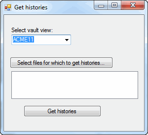

' Postconditions:
' 1. Displays the Get histories dialog box.
'    a. Select a vault view.
'    b. Click Select files for which to get histories.
'    c. In the Select File dialog:
'       1. Select one or more checked-in vault files.
'       2. Click Open.
'       3. Updates all version comments for the selected files to
'          "New comment".
'    d. Click Get histories.
'    e. Displays a message box for each history item.
'    f. Observe the updated version comments.
'    g. Click OK to close each message box.
' 2. Close the Get histories dialog box.

        Me.VaultsLabel = New System.Windows.Forms.Label()
        Me.VaultsComboBox = New System.Windows.Forms.ComboBox()
        Me.SelectFiles = New System.Windows.Forms.Button()
        Me.File1List = New System.Windows.Forms.ListBox()
        Me.GetHistories = New System.Windows.Forms.Button()
        Me.OpenFileDialog1 = New System.Windows.Forms.OpenFileDialog()
        Me.SuspendLayout()
        'VaultsLabel
        Me.VaultsLabel.AutoSize = True
        Me.VaultsLabel.Location = New System.Drawing.Point(12, 24)
        Me.VaultsLabel.Name = "VaultsLabel"
        Me.VaultsLabel.Size = New System.Drawing.Size(91, 13)
        Me.VaultsLabel.TabIndex = 0
        Me.VaultsLabel.Text = "Select vault view:"
        'VaultsComboBox
        Me.VaultsComboBox.FormattingEnabled = True
        Me.VaultsComboBox.Location = New System.Drawing.Point(15, 40)
        Me.VaultsComboBox.Name = "VaultsComboBox"
        Me.VaultsComboBox.Size = New System.Drawing.Size(121, 21)
        Me.VaultsComboBox.TabIndex = 1
        'SelectFiles
        Me.SelectFiles.Location = New System.Drawing.Point(12, 85)
        Me.SelectFiles.Name = "SelectFiles"
        Me.SelectFiles.Size = New System.Drawing.Size(209, 23)
        Me.SelectFiles.TabIndex = 2
        Me.SelectFiles.Text = "Select files for which to get histories..."
        Me.SelectFiles.UseVisualStyleBackColor = True
        'File1List
        Me.File1List.FormattingEnabled = True
        Me.File1List.HorizontalScrollbar = True
        Me.File1List.Location = New System.Drawing.Point(15, 114)
        Me.File1List.Name = "File1List"
        Me.File1List.SelectionMode = System.Windows.Forms.SelectionMode.MultiExtended
        Me.File1List.Size = New System.Drawing.Size(257, 56)
        Me.File1List.TabIndex = 4
        'GetHistories
        Me.GetHistories.Location = New System.Drawing.Point(40, 183)
        Me.GetHistories.Name = "GetHistories"
        Me.GetHistories.Size = New System.Drawing.Size(157, 23)
        Me.GetHistories.TabIndex = 6
        Me.GetHistories.Text = "Get histories"
        Me.GetHistories.UseVisualStyleBackColor = True
        'OpenFileDialog1
        Me.OpenFileDialog1.FileName = "OpenFileDialog1"
        Me.OpenFileDialog1.Multiselect = True
        Me.OpenFileDialog1.Title = "Select File"
        'Form1
        Me.AutoScaleDimensions = New System.Drawing.SizeF(6.0!, 13.0!)
        Me.AutoScaleMode = System.Windows.Forms.AutoScaleMode.Font
        Me.ClientSize = New System.Drawing.Size(284, 229)
        Me.Controls.Add(Me.GetHistories)
        Me.Controls.Add(Me.File1List)
        Me.Controls.Add(Me.SelectFiles)
        Me.Controls.Add(Me.VaultsComboBox)
        Me.Controls.Add(Me.VaultsLabel)
        Me.Name = "Form1"
        Me.Text = "Get histories"
        Me.ResumeLayout(False)
        Me.PerformLayout()
