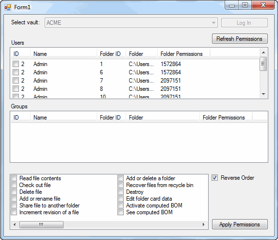

This example shows how to create an application that displays a form in which a user can assign permissions to folders for users and groups in a vault.

'  6. Create a form similar to the form shown above with the following controls:
'     a. Label1 (label control with text, "Select vault:")
'     b. comboVault (combo box)
'     c. buttonLogIn (button with text, "Log In")
'     d. Label2 (label with text, "Users")
'     e. buttonRefresh (button with text, "Refresh Permissions")
'     f. listViewUsers (list view control)
'        ColumnHeader1
(ID)
'        ColumnHeader2
(Name)
'        ColumnHeader3
(Folder ID)
'        ColumnHeader7
(Folder)
'        ColumnHeader8
(Folder Permissions)
'     g. Label3 (label with text, "Groups")
h. listViewGroups (list view control)
'        ColumnHeader4
(ID)
'        ColumnHeader5
(Name)
'        ColumnHeader6
(Folder ID)
'        ColumnHeader9
(Folder)
'        ColumnHeader10
'     i. listViewPermissions (list view control)
'     j. checkboxReverseOrder (check box with text, "Reverse Order")
'     k. buttonApply (button with text, "Apply Permissions")

' Postconditions:
' 1. In the Form1 dialog, select a vault and click Log In.
'    Wait for the application to populate the Users and Groups list boxes.
' 2. Click permissions in the list box located left of the Reverse Order check box.
' 3. Optionally select the Reverse Order check box.
' 4. Select the check boxes in front of the users and folders to which to assign permissions.
' 5. Click Apply Permissions.
'    Wait for the application to populate the Users list.
'    The folder permissions are updated for the selected users.
' 6. Select the check boxes in front of the groups and folders to which to assign permissions.
' 7. Click Apply Permissions.
'    Wait for the application to populate the Groups list.
'    The folder permissions are updated for the selected groups.

' Form1.Designer.vb
<Global.Microsoft.VisualBasic.CompilerServices.DesignerGenerated()> _
Partial Class Form1
    Inherits System.Windows.Forms.Form
    'Form overrides dispose to clean up the component list.
    <System.Diagnostics.DebuggerNonUserCode()> _
    Protected Overrides Sub Dispose(ByVal disposing As Boolean)
        Try
            If disposing AndAlso components IsNot Nothing Then
                components.Dispose()
            End If
        Finally
            MyBase.Dispose(disposing)
        End Try
    End Sub
    'Required by the Windows Form Designer
    Private components As System.ComponentModel.IContainer
    'NOTE: The following procedure is required by the Windows Form Designer
    'It can be modified using the Windows Form Designer.
    'Do not modify it using the code editor.
    <System.Diagnostics.DebuggerStepThrough()> _
    Private Sub InitializeComponent()
        Me.Label1 = New System.Windows.Forms.Label()
        Me.comboVault = New System.Windows.Forms.ComboBox()
        Me.buttonLogIn = New System.Windows.Forms.Button()
        Me.Label2 = New System.Windows.Forms.Label()
        Me.listViewUsers = New System.Windows.Forms.ListView()
        Me.ColumnHeader1 = CType(New System.Windows.Forms.ColumnHeader(), System.Windows.Forms.ColumnHeader)
        Me.ColumnHeader2 = CType(New System.Windows.Forms.ColumnHeader(), System.Windows.Forms.ColumnHeader)
        Me.ColumnHeader3 = CType(New System.Windows.Forms.ColumnHeader(), System.Windows.Forms.ColumnHeader)
        Me.ColumnHeader7 = CType(New System.Windows.Forms.ColumnHeader(), System.Windows.Forms.ColumnHeader)
        Me.ColumnHeader8 = CType(New System.Windows.Forms.ColumnHeader(), System.Windows.Forms.ColumnHeader)
        Me.Label3 = New System.Windows.Forms.Label()
        Me.buttonApply = New System.Windows.Forms.Button()
        Me.buttonRefresh = New System.Windows.Forms.Button()
        Me.listViewGroups = New System.Windows.Forms.ListView()
        Me.ColumnHeader4 = CType(New System.Windows.Forms.ColumnHeader(), System.Windows.Forms.ColumnHeader)
        Me.ColumnHeader5 = CType(New System.Windows.Forms.ColumnHeader(), System.Windows.Forms.ColumnHeader)
        Me.ColumnHeader6 = CType(New System.Windows.Forms.ColumnHeader(), System.Windows.Forms.ColumnHeader)
        Me.ColumnHeader9 = CType(New System.Windows.Forms.ColumnHeader(), System.Windows.Forms.ColumnHeader)
        Me.ColumnHeader10 = CType(New System.Windows.Forms.ColumnHeader(), System.Windows.Forms.ColumnHeader)
        Me.listViewPermissions = New System.Windows.Forms.ListView()
        Me.checkboxReverseOrder = New System.Windows.Forms.CheckBox()
        Me.SuspendLayout()
        'Label1
        Me.Label1.AutoSize = True
        Me.Label1.Location = New System.Drawing.Point(12, 9)
        Me.Label1.Name = "Label1"
        Me.Label1.Size = New System.Drawing.Size(66, 13)
        Me.Label1.TabIndex = 0
        Me.Label1.Text = "Select vault:"
        'comboVault
        Me.comboVault.DropDownStyle = System.Windows.Forms.ComboBoxStyle.DropDownList
        Me.comboVault.FormattingEnabled = True
        Me.comboVault.Location = New System.Drawing.Point(84, 6)
        Me.comboVault.Name = "comboVault"
        Me.comboVault.Size = New System.Drawing.Size(357, 21)
        Me.comboVault.TabIndex = 1
        'buttonLogIn
        Me.buttonLogIn.Location = New System.Drawing.Point(447, 6)
        Me.buttonLogIn.Name = "buttonLogIn"
        Me.buttonLogIn.Size = New System.Drawing.Size(98, 21)
        Me.buttonLogIn.TabIndex = 2
        Me.buttonLogIn.Text = "Log In"
        Me.buttonLogIn.UseVisualStyleBackColor = True
        'Label2
        Me.Label2.AutoSize = True
        Me.Label2.Location = New System.Drawing.Point(12, 51)
        Me.Label2.Name = "Label2"
        Me.Label2.Size = New System.Drawing.Size(34, 13)
        Me.Label2.TabIndex = 3
        Me.Label2.Text = "Users"
        'listViewUsers
        Me.listViewUsers.CheckBoxes = True
        Me.listViewUsers.Columns.AddRange(New System.Windows.Forms.ColumnHeader() {Me.ColumnHeader1, Me.ColumnHeader2, Me.ColumnHeader3, Me.ColumnHeader7, Me.ColumnHeader8})
        Me.listViewUsers.Location = New System.Drawing.Point(12, 67)
        Me.listViewUsers.Name = "listViewUsers"
        Me.listViewUsers.Size = New System.Drawing.Size(533, 107)
        Me.listViewUsers.TabIndex = 4
        Me.listViewUsers.UseCompatibleStateImageBehavior = False
        Me.listViewUsers.View = System.Windows.Forms.View.Details
        'ColumnHeader1
        Me.ColumnHeader1.Text = "ID"
        Me.ColumnHeader1.Width = 41
        'ColumnHeader2
        Me.ColumnHeader2.Text = "Name"
        Me.ColumnHeader2.Width = 137
        'ColumnHeader3
        Me.ColumnHeader3.Text = "Folder ID"
        'ColumnHeader7
        Me.ColumnHeader7.Text = "Folder"
        Me.ColumnHeader7.Width = 152
        'ColumnHeader8
        Me.ColumnHeader8.Text = "Folder Permissions"
        Me.ColumnHeader8.Width = 108
        'Label3
        Me.Label3.AutoSize = True
        Me.Label3.Location = New System.Drawing.Point(12, 182)
        Me.Label3.Name = "Label3"
        Me.Label3.Size = New System.Drawing.Size(41, 13)
        Me.Label3.TabIndex = 5
        Me.Label3.Text = "Groups"
        'buttonApply
        Me.buttonApply.Enabled = False
        Me.buttonApply.Location = New System.Drawing.Point(428, 420)
        Me.buttonApply.Name = "buttonApply"
        Me.buttonApply.Size = New System.Drawing.Size(117, 23)
        Me.buttonApply.TabIndex = 7
        Me.buttonApply.Text = "Apply Permissions"
        Me.buttonApply.UseVisualStyleBackColor = True
        'buttonRefresh
        Me.buttonRefresh.Enabled = False
        Me.buttonRefresh.Location = New System.Drawing.Point(428, 38)
        Me.buttonRefresh.Name = "buttonRefresh"
        Me.buttonRefresh.Size = New System.Drawing.Size(117, 23)
        Me.buttonRefresh.TabIndex = 8
        Me.buttonRefresh.Text = "Refresh Permissions"
        Me.buttonRefresh.UseVisualStyleBackColor = True
        'listViewGroups
        Me.listViewGroups.CheckBoxes = True
        Me.listViewGroups.Columns.AddRange(New System.Windows.Forms.ColumnHeader() {Me.ColumnHeader4, Me.ColumnHeader5, Me.ColumnHeader6, Me.ColumnHeader9, Me.ColumnHeader10})
        Me.listViewGroups.Location = New System.Drawing.Point(12, 198)
        Me.listViewGroups.Name = "listViewGroups"
        Me.listViewGroups.Size = New System.Drawing.Size(533, 107)
        Me.listViewGroups.TabIndex = 9
        Me.listViewGroups.UseCompatibleStateImageBehavior = False
        Me.listViewGroups.View = System.Windows.Forms.View.Details
        'ColumnHeader4
        Me.ColumnHeader4.Text = "ID"
        Me.ColumnHeader4.Width = 41
        'ColumnHeader5
        Me.ColumnHeader5.Text = "Name"
        Me.ColumnHeader5.Width = 137
        'ColumnHeader6
        Me.ColumnHeader6.Text = "Folder ID"
        'ColumnHeader9
        Me.ColumnHeader9.Text = "Folder"
        Me.ColumnHeader9.Width = 152
        'ColumnHeader10
        Me.ColumnHeader10.Text = "Folder Permissions"
        Me.ColumnHeader10.Width = 108
        'listViewPermissions
        Me.listViewPermissions.CheckBoxes = True
        Me.listViewPermissions.Location = New System.Drawing.Point(12, 328)
        Me.listViewPermissions.Name = "listViewPermissions"
        Me.listViewPermissions.Size = New System.Drawing.Size(410, 115)
        Me.listViewPermissions.TabIndex = 10
        Me.listViewPermissions.UseCompatibleStateImageBehavior = False
        Me.listViewPermissions.View = System.Windows.Forms.View.List
        'checkboxReverseOrder
        Me.checkboxReverseOrder.AutoSize = True
        Me.checkboxReverseOrder.Location = New System.Drawing.Point(428, 328)
        Me.checkboxReverseOrder.Name = "checkboxReverseOrder"
        Me.checkboxReverseOrder.Size = New System.Drawing.Size(95, 17)
        Me.checkboxReverseOrder.TabIndex = 11
        Me.checkboxReverseOrder.Text = "Reverse Order"
        Me.checkboxReverseOrder.UseVisualStyleBackColor = True
        'Form1
        Me.AutoScaleDimensions = New System.Drawing.SizeF(6.0!, 13.0!)
        Me.AutoScaleMode = System.Windows.Forms.AutoScaleMode.Font
        Me.ClientSize = New System.Drawing.Size(557, 455)
        Me.Controls.Add(Me.checkboxReverseOrder)
        Me.Controls.Add(Me.listViewPermissions)
        Me.Controls.Add(Me.listViewGroups)
        Me.Controls.Add(Me.buttonRefresh)
        Me.Controls.Add(Me.buttonApply)
        Me.Controls.Add(Me.Label3)
        Me.Controls.Add(Me.listViewUsers)
        Me.Controls.Add(Me.Label2)
        Me.Controls.Add(Me.buttonLogIn)
        Me.Controls.Add(Me.comboVault)
        Me.Controls.Add(Me.Label1)
        Me.Name = "Form1"
        Me.Text = "Folder Permissions"
        Me.ResumeLayout(False)
        Me.PerformLayout()
    End Sub
    Friend WithEvents Label1 As System.Windows.Forms.Label
    Friend WithEvents comboVault As System.Windows.Forms.ComboBox
    Friend WithEvents buttonLogIn As System.Windows.Forms.Button
    Friend WithEvents Label2 As System.Windows.Forms.Label
    Friend WithEvents listViewUsers As System.Windows.Forms.ListView
    Friend WithEvents ColumnHeader1 As System.Windows.Forms.ColumnHeader
    Friend WithEvents ColumnHeader2 As System.Windows.Forms.ColumnHeader
    Friend WithEvents ColumnHeader3 As System.Windows.Forms.ColumnHeader
    Friend WithEvents Label3 As System.Windows.Forms.Label
    Friend WithEvents buttonApply As System.Windows.Forms.Button
    Friend WithEvents buttonRefresh As System.Windows.Forms.Button
    Friend WithEvents ColumnHeader7 As System.Windows.Forms.ColumnHeader
    Friend WithEvents ColumnHeader8 As System.Windows.Forms.ColumnHeader
    Friend WithEvents listViewGroups As System.Windows.Forms.ListView
    Friend WithEvents ColumnHeader4 As System.Windows.Forms.ColumnHeader
    Friend WithEvents ColumnHeader5 As System.Windows.Forms.ColumnHeader
    Friend WithEvents ColumnHeader6 As System.Windows.Forms.ColumnHeader
    Friend WithEvents ColumnHeader9 As System.Windows.Forms.ColumnHeader
    Friend WithEvents ColumnHeader10 As System.Windows.Forms.ColumnHeader
    Friend WithEvents listViewPermissions As System.Windows.Forms.ListView
    Friend WithEvents checkboxReverseOrder As System.Windows.Forms.CheckBox
End Class
