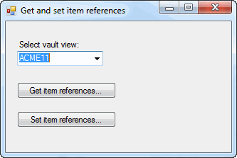

// Postconditions:
// 1. Displays the Get
and set item references dialog box.
// 2. Select a vault view.
// 3. Click Get
item references.
a. Click an item folder
in the vault.
// b. Click OK.
// c. Displays a message box confirming your folder selection.
// d. Click OK.
// e. Displays a message box with item references for the
first item found
// in the selected folder.
// f. Click OK.
// 4. Click Set item references.
// a. Click one or more files to add as references to the
item.
// b. Click Open.
// c. Displays a message box with the updated references.
// - or -
// Displays a message box with errors.
// d. Click OK.
// 5. Close the Get

this.VaultsComboBox = new System.Windows.Forms.ComboBox();
this.GetItemRefs = new System.Windows.Forms.Button();
this.OpenFileDialog = new System.Windows.Forms.OpenFileDialog();
this.Button1 = new System.Windows.Forms.Button();
this.SuspendLayout();
//VaultsLabel
this.VaultsLabel.AutoSize = true;
this.VaultsLabel.Location = new System.Drawing.Point(13, 26);
this.VaultsLabel.Name = "VaultsLabel";
this.VaultsLabel.Size = new System.Drawing.Size(94, 13);
this.VaultsLabel.TabIndex = 0;
this.VaultsLabel.Text = " Select vault view:";
//VaultsComboBox
this.VaultsComboBox.FormattingEnabled = true;
this.VaultsComboBox.Location = new System.Drawing.Point(16, 42);
this.VaultsComboBox.Name = "VaultsComboBox";
this.VaultsComboBox.Size = new System.Drawing.Size(121, 21);
this.VaultsComboBox.TabIndex = 1;
//GetItemRefs
this.GetItemRefs.Location = new System.Drawing.Point(16, 86);
this.GetItemRefs.Name = "GetItemRefs";
this.GetItemRefs.Size = new System.Drawing.Size(139, 23);
this.GetItemRefs.TabIndex = 5;
this.GetItemRefs.Text = "Get item references...";
this.GetItemRefs.UseVisualStyleBackColor = true;
this.GetItemRefs.Click +=new System.EventHandler(GetItemRefs_Click);
//OpenFileDialog
this.OpenFileDialog.Title = "Open";
//Button1
this.Button1.Location = new System.Drawing.Point(16, 127);
this.Button1.Name = "Button1";
this.Button1.Size = new System.Drawing.Size(139, 23);
this.Button1.TabIndex = 6;
this.Button1.Text = "Set item references...";
this.Button1.UseVisualStyleBackColor = true;
this.Button1.Click +=new System.EventHandler(Button1_Click);
//Form1
this.AutoScaleDimensions = new System.Drawing.SizeF(6f, 13f);
this.AutoScaleMode = System.Windows.Forms.AutoScaleMode.Font;
this.ClientSize = new System.Drawing.Size(317, 185);
this.Controls.Add(this.Button1);
this.Controls.Add(this.GetItemRefs);
this.Controls.Add(this.VaultsComboBox);
this.Controls.Add(this.VaultsLabel);
this.Name = "Form1";
this.Text = "Get and set item references";
this.Load += new System.EventHandler(this.Form1_Load);
this.ResumeLayout(false);
this.PerformLayout();
#endregion
internal System.Windows.Forms.Label VaultsLabel;
internal System.Windows.Forms.ComboBox VaultsComboBox;
internal System.Windows.Forms.Button GetItemRefs;
internal System.Windows.Forms.OpenFileDialog OpenFileDialog;
internal System.Windows.Forms.Button Button1;
