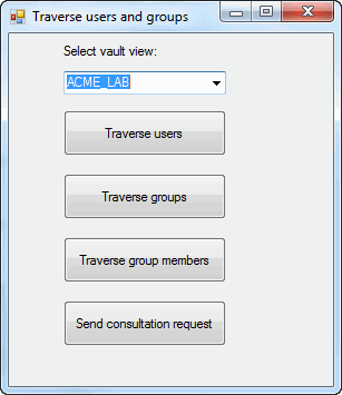

This example shows how to traverse the users and groups in a vault and send a message, also called a notification, to all users in the vault.
NOTE: If using the .NET Framework 4.0 primary interop assembly provided with SOLIDWORKS Enterprise PDM, see Using .NET Framework 4.0 in Stand-alone Applications.

//     f. Create a form similar to the form shown above and change:
//        1. Top label to VaultsLabel.
//        2. Combo box to VaultsComboBox.
//        3. Traverse users button to TraverseUsersButton.
//        4. Traverse groups button to TraverseGroupsButton.
//        5. Traverse group members button to TraverseGroupMembersButton.
//        6. Send consultation request button to SendConsultationRequestButton.
//     g. Replace the code in Form1.cs with this code.
//     h. Replace the code in Form1.Designer.cs with this code.

//  1. Displays a dialog.
//  2. Select a vault.
//  3. Click Traverse users.
//     A message box is displayed showing the users
//     in the vault.
//  4. Click OK to close the message box.
//  5. Click Traverse groups.
//     the groups in the vault.
//  6. Click OK to close the message box.
//  7. Click Traverse group members.
//     the groups, and the users in those groups, in
//     the vault.
//  8. Click OK to close the message box.
//  9. Click Send consultation request.
//     After several minutes, a SOLIDWORKS Enterprise PDM notification
//     is displayed only to logged-in users.
// 10. To open the the message, click:
//     * either the notification while it is displayed or
//       the SOLIDWORKS Enterprise PDM tray icon.
//       - or -
//     * Tools > Inbox in Windows Explorer.
// 11. Close the dialog.

            this.TraverseGroupMembersButton.TabIndex = 4;
            this.TraverseGroupMembersButton.Text = "Traverse group members";
            this.TraverseGroupMembersButton.UseVisualStyleBackColor = true;
            this.TraverseGroupMembersButton.Click += new System.EventHandler(this.TraverseGroupMembersButton_Click);
            // SendConsultationRequestButton
            this.SendConsultationRequestButton.Location = new System.Drawing.Point(29, 279);
            this.SendConsultationRequestButton.Name = "SendConsultationRequestButton";
            this.SendConsultationRequestButton.Size = new System.Drawing.Size(168, 35);
            this.SendConsultationRequestButton.TabIndex = 5;
            this.SendConsultationRequestButton.Text = "Send consultation request";
            this.SendConsultationRequestButton.UseVisualStyleBackColor = true;
            this.SendConsultationRequestButton.Click += new System.EventHandler(this.SendConsultationRequestButton_Click);
            // Form1
            this.AutoScaleDimensions = new System.Drawing.SizeF(6F, 13F);
            this.AutoScaleMode = System.Windows.Forms.AutoScaleMode.Font;
            this.ClientSize = new System.Drawing.Size(284, 342);
            this.Controls.Add(this.SendConsultationRequestButton);
            this.Controls.Add(this.TraverseGroupMembersButton);
            this.Controls.Add(this.TraverseGroupsButton);
            this.Controls.Add(this.TraverseUsersButton);
            this.Controls.Add(this.VaultsComboBox);
            this.Controls.Add(this.VaultsLabel);
            this.Name = "Form1";
            this.Text = "Traverse users and groups";
            this.Load += new System.EventHandler(this.UsersAndGroupsCSharp_Load);
            this.ResumeLayout(false);
            this.PerformLayout();
        #endregion
        private System.Windows.Forms.Label VaultsLabel;
        private System.Windows.Forms.ComboBox VaultsComboBox;
        private System.Windows.Forms.Button TraverseUsersButton;
        private System.Windows.Forms.Button TraverseGroupsButton;
        private System.Windows.Forms.Button TraverseGroupMembersButton;
        private System.Windows.Forms.Button SendConsultationRequestButton;
