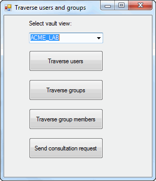

This example shows how to traverse the users and groups in a vault and send a message, also called a notification, to all users in the vault.
NOTE: If using the .NET Framework 4.0 primary interop assembly provided with SOLIDWORKS Enterprise PDM, see Using .NET Framework 4.0 in Stand-alone Applications.

'     f. Create a form similar to the form shown above and change:
'        1. Top label to VaultsLabel.
'        2. Combo box to VaultsComboBox.
'        3. Traverse users button to TraverseUsersButton.
'        4. Traverse groups button to TraverseGroupsButton.
'        5. Traverse group members button to TraverseGroupMembersButton.
'        6. Send consultation request button to SendConsultationRequestButton.
'     g. Replace the code in Form1.vb with this code.

' Postconditions:
'  1. Displays a dialog.
'  2. Select a vault.
'  3. Click Traverse users.
'     A message box is displayed showing the users
'     in the vault.
'  4. Click OK to close the message box.
'  5. Click Traverse groups.
'     the groups in the vault.
'  6. Click OK to close the message box.
'  7. Click Traverse group members.
'     the groups, and the users in those groups, in
'     the vault.
'  8. Click OK to close the message box.
'  9. Click Send consultation request.
'     After several minutes, a SOLIDWORKS Enterprise PDM notification
'     is displayed only to logged-in users.
' 10. To open the the message, click:
'     * either the notification while it is displayed or
'       the SOLIDWORKS Enterprise PDM tray icon.
'       - or -
'     * Tools > Inbox in Windows Explorer.
' 11. Close the dialog.

        Me.TraverseGroupsButton.TabIndex = 16
        Me.TraverseGroupsButton.Text = "Traverse groups"
        Me.TraverseGroupsButton.UseVisualStyleBackColor = True
        'TraverseGroupMembersButton
        Me.TraverseGroupMembersButton.Location = New System.Drawing.Point(49, 183)
        Me.TraverseGroupMembersButton.Margin = New System.Windows.Forms.Padding(2, 2, 2, 2)
        Me.TraverseGroupMembersButton.Name = "TraverseGroupMembersButton"
        Me.TraverseGroupMembersButton.Size = New System.Drawing.Size(146, 41)
        Me.TraverseGroupMembersButton.TabIndex = 17
        Me.TraverseGroupMembersButton.Text = "Traverse group members"
        Me.TraverseGroupMembersButton.UseVisualStyleBackColor = True
        'SendConsultationRequestButton
        Me.SendConsultationRequestButton.Location = New System.Drawing.Point(49, 240)
        Me.SendConsultationRequestButton.Margin = New System.Windows.Forms.Padding(2, 2, 2, 2)
        Me.SendConsultationRequestButton.Name = "SendConsultationRequestButton"
        Me.SendConsultationRequestButton.Size = New System.Drawing.Size(146, 41)
        Me.SendConsultationRequestButton.TabIndex = 18
        Me.SendConsultationRequestButton.Text = "Send consultation request"
        Me.SendConsultationRequestButton.UseVisualStyleBackColor = True
        'UsersAndGroups
        Me.AutoScaleDimensions = New System.Drawing.SizeF(6.0!, 13.0!)
        Me.AutoScaleMode = System.Windows.Forms.AutoScaleMode.Font
        Me.ClientSize = New System.Drawing.Size(291, 317)
        Me.Controls.Add(Me.SendConsultationRequestButton)
        Me.Controls.Add(Me.TraverseGroupMembersButton)
        Me.Controls.Add(Me.TraverseGroupsButton)
        Me.Controls.Add(Me.TraverseUsersButton)
        Me.Controls.Add(Me.VaultsComboBox)
        Me.Controls.Add(Me.VaultsLabel)
        Me.Margin = New System.Windows.Forms.Padding(2, 2, 2, 2)
        Me.Name = "UsersAndGroups"
        Me.Text = "Traverse users and groups"
        Me.ResumeLayout(False)
        Me.PerformLayout()
    End Sub
   Friend WithEvents VaultsComboBox As System.Windows.Forms.ComboBox
   Friend WithEvents VaultsLabel As System.Windows.Forms.Label
   Friend WithEvents TraverseUsersButton As System.Windows.Forms.Button
   Friend WithEvents TraverseGroupsButton As System.Windows.Forms.Button
   Friend WithEvents TraverseGroupMembersButton As System.Windows.Forms.Button
   Friend WithEvents SendConsultationRequestButton As System.Windows.Forms.Button
End Class
