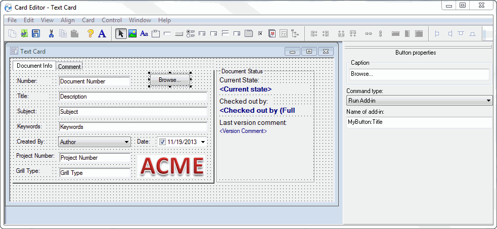

Click Cards > File Cards.
Double-click Text Card.
Add
a button to the card.
Click the button.
In Caption, type Browse....
In
Command
type, select Run Add-in.
In Name of add-in, type
MyButton:Title.
Save the card and exit the
Card Editor.
Open
Windows Explorer on the vault and select a checked-out text
file.
Click
Browse
in the file's data card.
The
Select File for Title dialog box pops up.
Browse to and select the
checked-out text file.
Click Open
to copy the path of the selected file to the Title field of the
file's data card.
