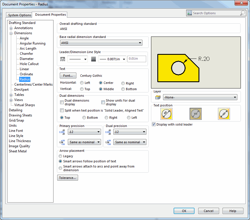

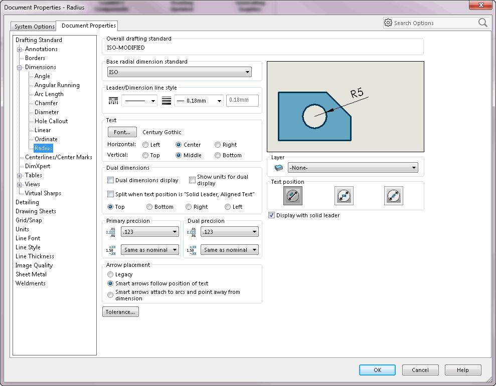

Document Properties > Dimensions > Radius
This topic contains two tables. The information in the table:
  • appearing immediately after the screen capture of the Document Properties - Radius dialog corresponds to the settings on that dialog.
  • titled Obsolete Enumerators contains enumerators that previously appeared on the dialog, but are now obsolete and no longer appear on that dialog.
Setting
Get/Set Methods
Return Value or <Value>
Comments
Base radial dimension standard
IModelDocExtension::GetUserPreferenceInteger(swUserPreferenceIntegerValue_e.swDetailingDimensionStandard, swUserPreferenceOption_e.swDetailingRadiusDimension)
IModelDocExtension::SetUserPreferenceInteger(swUserPreferenceIntegerValue_e.swDetailingDimensionStandard, swUserPreferenceOption_e.swDetailingRadiusDimension, swDetailingStandard_e.<Value>)
See swDetailingStandard_e for valid options
Specifies the base radial dimensioning standard to use

Arrow placement
IModelDocExtension::GetUserPreferenceInteger(swUserPreferenceIntegerValue_e.swDetailingRadialDimsArrowPlacement, swUserPreferenceOption_e.swDetailingRadiusDimension)
IModelDocExtension::SetUserPreferenceInteger(swUserPreferenceIntegerValue_e.swDetailingRadialDimsArrowPlacement, swUserPreferenceOption_e.swDetailingRadiusDimension, swArrowPlacement_e .<Value>)
See swArrowPlacement_e for valid options
Specifies placement of Smart arrows only
Display with solid leader
IModelDocExtension::GetUserPreferenceToggle(swUserPreferenceToggle_e.swDetailingRadialDimsDisplayWithSolidLeader, swUserPreferenceOption_e.swDetailingRadiusDimension)
IModelDocExtension::SetUserPreferenceToggle(swUserPreferenceToggle_e.swDetailingRadialDimsDisplayWithSolidLeader, swUserPreferenceOption_e.swDetailingRadiusDimension, <Value>)
Boolean value
Specifies whether to display radial dimensions with a solid leader
