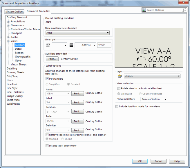

Document Properties > Views > Auxiliary
Setting
Get/Set Methods
Return Value or <Value>
Comments
Base auxiliary view standard
IModelDocExtension::GetUserPreferenceInteger(swUserPreferenceIntegerValue_e.swDetailingDimensionStandard, swUserPreferenceOption_e.swDetailingAuxiliaryView)
IModelDocExtension::SetUserPreferenceInteger(swUserPreferenceIntegerValue_e.swDetailingDimensionStandard, swUserPreferenceOption_e.swDetailingAuxiliaryView, swDetailingStandard_e.<Value>)
See swDetailingStandard_e for valid options
Specifies the base auxiliary view standard to use
Line style - Line Style
IModelDocExtension::GetUserPreferenceInteger(swUserPreferenceIntegerValue_e.swLineFontViewArrowStyle, swUserPreferenceOption_e.swDetailingNoOptionSpecified)
IModelDocExtension::SetUserPreferenceInteger(swUserPreferenceIntegerValue_e.swLineFontViewArrowStyle, swUserPreferenceOption_e.swDetailingNoOptionSpecified, swLineStyles_e.<Value>)
See swLineStyles_e for valid options
Specifies style of view arrows
Line style - Line Thickness
IModelDocExtension::GetUserPreferenceInteger(swUserPreferenceIntegerValue_e.swLineFontViewArrowThickness, swUserPreferenceOption_e.swDetailingNoOptionSpecified)
IModelDocExtension::SetUserPreferenceInteger(swUserPreferenceIntegerValue_e.swLineFontViewArrowThickness, swUserPreferenceOption_e.swDetailingNoOptionSpecified, swLineWeights_e.<Value>)
See swLineWeights_e for valid options
Specifies thickness of view arrows
Line style - Custom thickness
IModelDocExtension::GetUserPreferenceDouble(swUserPreferenceDoubleValue_e.swLineViewArrowThicknessCustom, swUserPreferenceOption_e.swDetailingNoOptionSpecified)
IModelDocExtension::SetUserPreferenceDouble(swUserPreferenceDoubleValue_e.swLineViewArrowThicknessCustom, swUserPreferenceOption_e.swDetailingNoOptionSpecified, <Value>)
Double value
Specifies custom thickness of auxiliary view arrow lines; sets Custom Thickness to the specified thickness and Leader Thickness to Custom Size
Auxiliary arrow text - Font...
IModelDocExtension::GetUserPreferenceTextFormat(swUserPreferenceTextFormat_e.swDetailingViewArrowTextFormat, swUserPreferenceOption_e.swDetailingNoOptionSpecified)
IModelDocExtension::SetUserPreferenceTextFormat(swUserPreferenceTextFormat_e.swDetailingViewArrowTextFormat, swUserPreferenceOption_e.swDetailingNoOptionSpecified, <Value>)
See ITextFormat for font options
To set font property values, implement ITextFormat, set the appropriate ITextFormat member values, and pass the ITextFormat object in the API set method
Label options - Per standard
IModelDocExtension::GetUserPreferenceToggle(swUserPreferenceToggle_e.swDetailingAuxViewLabels_PerStandard, swUserPreferenceOption_e.swDetailingNoOptionSpecified)
IModelDocExtension::SetUserPreferenceToggle(swUserPreferenceToggle_e.swDetailingAuxViewLabels_PerStandard, swUserPreferenceOption_e.swDetailingNoOptionSpecified, <Value>)
Boolean value
If...
Then display the auxiliary view label according to the format...
True
Required by the current detailing standard
False
Determined by these document-level user preferences:
swDetailingAuxViewLabels_Name
swDetailingAuxViewLabels_Label
swDetailingAuxView_Rotation
swDetailingAuxViewLabels_Scale
swDetailingAuxViewLabels_Delimiter
Label options - Simplified or Detailed
IModelDocExtension::GetUserPreferenceToggle(swUserPreferenceToggle_e.swDetailingAuxView_SimplifiedDetailed, swUserPreferenceOption_e.swDetailingNoOptionSpecified)
IModelDocExtension::SetUserPreferenceToggle(swUserPreferenceToggle_e.swDetailingAuxView_SimplifiedDetailed, swUserPreferenceOption_e.swDetailingNoOptionSpecified, <Value>)
Boolean value
True sets the standard to "Simplified", false sets it to "Detailed"
Label options - Name
IModelDocExtension::GetUserPreferenceInteger(swUserPreferenceIntegerValue_e.swDetailingAuxViewLabels_Name, swUserPreferenceOption_e.swDetailingNoOptionSpecified)
IModelDocExtension::SetUserPreferenceInteger(swUserPreferenceIntegerValue_e.swDetailingAuxViewLabels_Name, swUserPreferenceOption_e.swDetailingNoOptionSpecified, swDetailingViewLabelsName_e.<Value>)
See swDetailingViewLabelsName_e for valid options
Specifies the label to use in front of the auxiliary view; if set to swDetailingViewLabelsName_e.swDetailingViewLabelsName_custom, then set Label options - Name (CUSTOM) to a custom label
IModelDocExtension::GetUserPreferenceString(swUserPreferenceStringValue_e.swDetailingAuxViewLabels_CustomName, swUserPreferenceOption_e.swDetailingAuxiliaryView)
IModelDocExtension::SetUserPreferenceString(swUserPreferenceStringValue_e.swDetailingAuxViewLabels_CustomName, swUserPreferenceOption_e.swDetailingAuxiliaryView, <Value>)
String value
Specifies the custom label to use in front of the auxiliary view; valid only if Label options - Name is set to swDetailingViewLabelsName_e.swDetailingViewLabelsName_custom
Label options - Name - Font
IModelDocExtension::GetUserPreferenceTextFormat(swUserPreferenceTextFormat_e.swDetailingAuxView_NameTextFormat, swUserPreferenceOption_e.swDetailingNoOptionSpecified)
IModelDocExtension::SetUserPreferenceTextFormat(swUserPreferenceTextFormat_e.swDetailingAuxView_NameTextFormat, swUserPreferenceOption_e.swDetailingNoOptionSpecified, <Value>)
Label options - Label
IModelDocExtension::GetUserPreferenceInteger(swUserPreferenceIntegerValue_e.swDetailingAuxViewLabels_Label, swUserPreferenceOption_e.swDetailingNoOptionSpecified)
IModelDocExtension::SetUserPreferenceInteger(swUserPreferenceIntegerValue_e.swDetailingAuxViewLabels_Label, swUserPreferenceOption_e.swDetailingNoOptionSpecified, swDetailingViewLabelsLabel_e.<Value>)
See swDetailingViewLabelsLabel_e for valid options
Specifies the format of the auxiliary view label
Label options - Label - Font
IModelDocExtension::GetUserPreferenceTextFormat(swUserPreferenceTextFormat_e.swDetailingAuxView_LabelTextFormat, swUserPreferenceOption_e.swDetailingNoOptionSpecified)
IModelDocExtension::SetUserPreferenceTextFormat(swUserPreferenceTextFormat_e.swDetailingAuxView_LabelTextFormat, swUserPreferenceOption_e.swDetailingNoOptionSpecified, <Value>)
Label options - Rotation
ModelDocExtension::GetUserPreferenceInteger(swUserPreferenceIntegerValue_e.swDetailingAuxView_Rotation, swUserPreferenceOption_e.swDetailingNoOptionSpecified)
IModelDocExtension::SetUserPreferenceInteger(swUserPreferenceIntegerValue_e.swDetailingAuxView_Rotation, swUserPreferenceOption_e.swDetailingNoOptionSpecified, swDetailingViewRotation_e .<Value>)
See swDetailingViewRotation_e for valid options
Label options - Rotation - Font
IModelDocExtension::GetUserPreferenceTextFormat(swUserPreferenceTextFormat_e.swDetailingAuxView_RotationTextFormat, swUserPreferenceOption_e.swDetailingNoOptionSpecified)
IModelDocExtension::SetUserPreferenceTextFormat(swUserPreferenceTextFormat_e.swDetailingAuxView_RotationTextFormat, swUserPreferenceOption_e.swDetailingNoOptionSpecified, <Value>)
Label options - Scale
IModelDocExtension::GetUserPreferenceInteger(swUserPreferenceIntegerValue_e.swDetailingAuxViewLabels_Scale, swUserPreferenceOption_e.swDetailingNoOptionSpecified)
IModelDocExtension::SetUserPreferenceInteger(swUserPreferenceIntegerValue_e.swDetailingAuxViewLabels_Scale, swUserPreferenceOption_e.swDetailingNoOptionSpecified, swDetailingViewLabelsScale_e.<Value>)
See swDetailingViewLabelsScale_e for valid options
Specifies the label to use in front of the scale value; if set to swDetailingViewLabelsScale_e.swDetailingViewLabelsScale_SCALEcustom, then set Label options - Scale (CUSTOM) to a custom scale label
IModelDocExtension::GetUserPreferenceString(swUserPreferenceStringValue_e.swDetailingAuxViewLabels_CustomScale, swUserPreferenceOption_e.swDetailingAuxiliaryView)
IModelDocExtension::SetUserPreferenceString(swUserPreferenceStringValue_e.swDetailingAuxViewLabels_CustomScale, swUserPreferenceOption_e.swDetailingAuxiliaryView, <Value>)
String value
Specifies the custom label to use in front of the scale value; valid only if Label options - Scale is set to swDetailingViewLabelsScale_e.swDetailingViewLabelsScale_SCALEcustom
Label options - Scale - Font
IModelDocExtension::GetUserPreferenceTextFormat(swUserPreferenceTextFormat_e.swDetailingAuxView_ScaleTextFormat, swUserPreferenceOption_e.swDetailingNoOptionSpecified)
IModelDocExtension::SetUserPreferenceTextFormat(swUserPreferenceTextFormat_e.swDetailingAuxView_ScaleTextFormat, swUserPreferenceOption_e.swDetailingNoOptionSpecified, <Value>)
Label options - Delimiter
IModelDocExtension::GetUserPreferenceInteger(swUserPreferenceIntegerValue_e.swDetailingAuxViewLabels_Delimiter, swUserPreferenceOption_e.swDetailingNoOptionSpecified)
IModelDocExtension::SetUserPreferenceInteger(swUserPreferenceIntegerValue_e.swDetailingAuxViewLabels_Delimiter, swUserPreferenceOption_e.swDetailingNoOptionSpecified, swDetailingViewLabelsDelimiter_e .<Value>)
See swDetailingViewLabelsDelimiter_e for valid options
Specifies the format of the scale value
Label options - Delimiter - Font
IModelDocExtension::GetUserPreferenceTextFormat(swUserPreferenceTextFormat_e.swDetailingAuxView_DelimiterTextFormat, swUserPreferenceOption_e.swDetailingNoOptionSpecified)
IModelDocExtension::SetUserPreferenceTextFormat(swUserPreferenceTextFormat_e.swDetailingAuxView_DelimiterTextFormat, swUserPreferenceOption_e.swDetailingNoOptionSpecified, <Value>)
Label options - Remove space in scale around colon (:) and slash (/)
IModelDocExtension::GetUserPreferenceToggle(swUserPreferenceToggle_e.swDetailingAuxView_RemoveSpaceInScale, swUserPreferenceOption_e.swDetailingNoOptionSpecified)
IModelDocExtension::SetUserPreferenceToggle(swUserPreferenceToggle_e.swDetailingAuxView_RemoveSpaceInScale, swUserPreferenceOption_e.swDetailingNoOptionSpecified, <Value>)
Boolean value
Specifies whether to remove spaces around the delimiter in the scale format
Label options -Stacked or In-line
IModelDocExtension::GetUserPreferenceToggle(swUserPreferenceToggle_e.swDetailingAuxViewLabels_Stacked, swUserPreferenceOption_e.swDetailingNoOptionSpecified)
IModelDocExtension::SetUserPreferenceToggle(swUserPreferenceToggle_e.swDetailingAuxViewLabels_Stacked, swUserPreferenceOption_e.swDetailingNoOptionSpecified, <Value>)
Boolean value
If...
Then display the auxiliary view name and scale in...
True
2 lines
False
1 line
Display label above view
IModelDocExtension::GetUserPreferenceToggle(swUserPreferenceToggle_e.swDetailingAuxViewLabels_AboveView, swUserPreferenceOption_e.swDetailingNoOptionSpecified)
IModelDocExtension::SetUserPreferenceToggle(swUserPreferenceToggle_e.swDetailingAuxViewLabels_AboveView, swUserPreferenceOption_e.swDetailingNoOptionSpecified, <Value>)
Boolean value
Specifies whether to show label above auxiliary view
Layer
IModelDocExtension::GetUserPreferenceString(swUserPreferenceStringValue_e.swDetailingLayer, swUserPreferenceOption_e.swDetailingAuxiliaryView)
IModelDocExtension::SetUserPreferenceString(swUserPreferenceStringValue_e.swDetailingLayer, swUserPreferenceOption_e.swDetailingAuxiliaryView, <Value>)
Valid Options:
  • "Border"
  • "Dimensions"
  • "Notes"
  • "BOM"
  • "FORMAT"
This setting is available only on drawings; depending on drawing, some options may not apply
View indication - Rotate view to be horizontal to sheet
IModelDocExtension::GetUserPreferenceToggle(swUserPreferenceToggle_e.swDetailingAuxView_RotateViewToHorizontalSheet, swUserPreferenceOption_e.swDetailingNoOptionSpecified)
IModelDocExtension::SetUserPreferenceToggle(swUserPreferenceToggle_e.swDetailingAuxView_RotateViewToHorizontalSheet, swUserPreferenceOption_e.swDetailingNoOptionSpecified, <Value>)
Boolean value
Specifies whether to rotate the view to be horizontal to the sheet
View indication - Clockwise or Counterclockwise
IModelDocExtension::GetUserPreferenceToggle(swUserPreferenceToggle_e.swDetailingAuxView_RotateClockwiseCounterclockwise, swUserPreferenceOption_e.swDetailingNoOptionSpecified)
IModelDocExtension::SetUserPreferenceToggle(swUserPreferenceToggle_e.swDetailingAuxView_RotateClockwiseCounterclockwise, swUserPreferenceOption_e.swDetailingNoOptionSpecified, <Value>)
Boolean value
True rotates the view clockwise, false rotates it counterclockwise
View indication - View indicators
IModelDocExtension::GetUserPreferenceInteger(swUserPreferenceIntegerValue_e.swDetailingAuxView_ViewIndication, swUserPreferenceOption_e.swDetailingNoOptionSpecified)
IModelDocExtension::SetUserPreferenceInteger(swUserPreferenceIntegerValue_e.swDetailingAuxView_ViewIndication, swUserPreferenceOption_e.swDetailingNoOptionSpecified, swViewIndication_e .<Value>)
See swViewIndication_e for valid options
Specifies the view indicator
Include location labels for new views
IModelDocExtension::GetUserPreferenceToggle(swUserPreferenceToggle_e.swDetailingAuxView_IncludeLocationLabelsForNewViews, swUserPreferenceOption_e.swDetailingNoOptionSpecified)
IModelDocExtension::SetUserPreferenceToggle(swUserPreferenceToggle_e.swDetailingAuxView_IncludeLocationLabelsForNewViews, swUserPreferenceOption_e.swDetailingNoOptionSpecified, <Value>)
Boolean value
Specifies whether to include location labels for new auxiliary views
