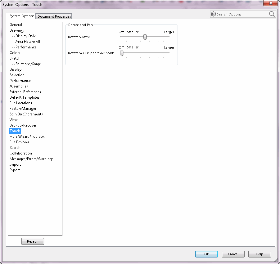

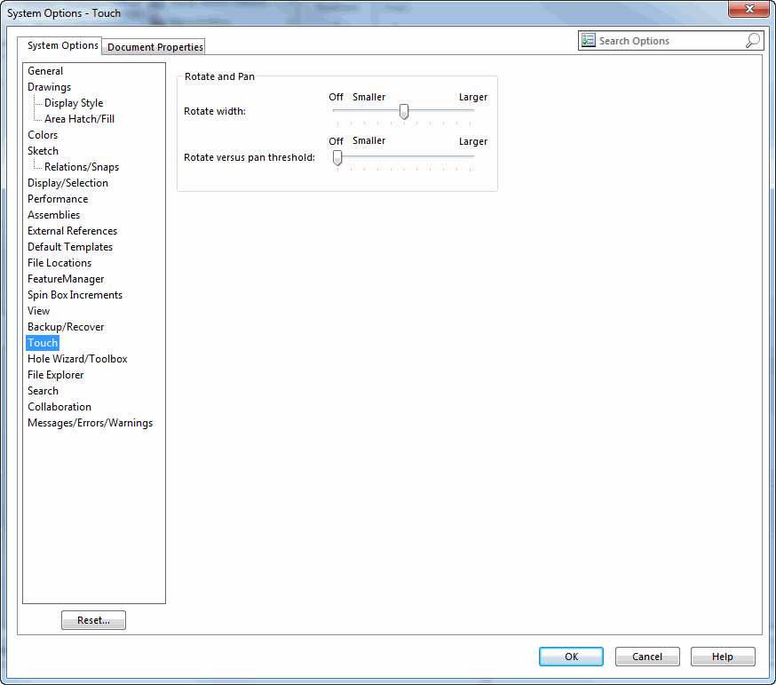

System Options > Touch
Setting
Get/Set Methods
Return Value or <Value>
Comment
Rotate and Pan - Rotate width
ISldWorks::GetUserPreferenceDoubleValue(swUserPreferenceDoubleValue_e.swSystemTouchRotateWidth)
ISldWorks::SetUserPreferenceDoubleValue(swUserPreferenceDoubleValue_e.swSystemTouchRotateWidth, <Value>)
Double value:
  • 0 = Interpret the two-finger gesture as a Pan
  • >0 = Interpret this maximum initial two-finger distance as a Rotate
Rotate and Pan - Rotate versus pan threshold
ISldWorks::GetUserPreferenceDoubleValue(swUserPreferenceDoubleValue_e.swSystemTouchRotateVersusPanThreshold)
ISldWorks::SetUserPreferenceDoubleValue(swUserPreferenceDoubleValue_e.swSystemTouchRotateVersusPanThreshold, <Value>)
Double value:
  • 0 = Interpret any two-finger distance greater than the Rotate width as a Pan
  • >0 (see Comment)
The sum of the non-zero threshold value and the Rotate width determines how SOLIDWORKS interprets two-finger gestures:
When the two-finger distance is... SOLIDWORKS...
Less than the sum and greater than the Rotate width Does not interpret the gesture
Greater than the sum Interprets the gesture as a Pan
Less than the Rotate width Interprets the gesture as a Rotate
