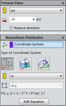

The above settings apply the following nonuniform pressure distribution with respect to the selected cartesian coordinate system:
P(x,y) = 20 (1+2*x+3*y2) psi
