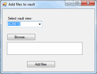

// 1. Displays the Add
files to vault dialog box.
// a. Select a vault view.
// b. Click Browse.
1. Locate and click three files outside the vault.
// 2. Click Open.
// c. Click
Add files.

// 2. Observe the changes in the vault.
// 3. Close the Add

this.AddFiles.Size = new System.Drawing.Size(98, 23);
this.AddFiles.TabIndex = 5;
this.AddFiles.Text = "Add files";
this.AddFiles.UseVisualStyleBackColor = true;
this.AddFiles.Click +=new System.EventHandler(AddFiles_Click);
//OpenFileDialog
this.OpenFileDialog.Multiselect = true;
this.OpenFileDialog.Title = "Open";
//Form1
this.AutoScaleDimensions = new System.Drawing.SizeF(6f, 13f);
this.AutoScaleMode = System.Windows.Forms.AutoScaleMode.Font;
this.ClientSize = new System.Drawing.Size(317, 215);
this.Controls.Add(this.AddFiles);
this.Controls.Add(this.ListBox);
this.Controls.Add(this.BrowseButton);
this.Controls.Add(this.VaultsComboBox);
this.Controls.Add(this.VaultsLabel);
this.Name = "Form1";
this.Text = "Add files to vault";
this.Load += new System.EventHandler(this.Form1_Load);
this.ResumeLayout(false);
this.PerformLayout();
#endregion
internal System.Windows.Forms.Label VaultsLabel;
internal System.Windows.Forms.ComboBox VaultsComboBox;
internal System.Windows.Forms.Button BrowseButton;
internal System.Windows.Forms.ListBox ListBox;
internal System.Windows.Forms.Button AddFiles;
internal System.Windows.Forms.OpenFileDialog OpenFileDialog;
