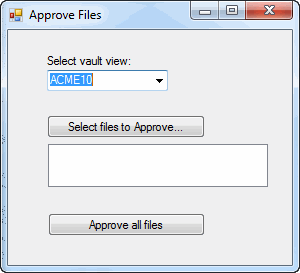

// 1. The Approve Files dialog box displays.
// a. Select a vault view.
// b. Click Select files to approve.
// c. In the Select File dialog:
// 1. Select vault files in the Waiting for Approval state.
// 2. Click Open.
// d. Click Approve all files.
// 2. Click OK in the Do Transition dialog box.
// The selected files change to the Approved state using the Passed Approval
// transition.
// 3. Close the Approve Files dialog box.

this.VaultsLabel = new System.Windows.Forms.Label();
this.VaultsComboBox = new System.Windows.Forms.ComboBox();
this.Transition = new System.Windows.Forms.Button();
this.File1List = new System.Windows.Forms.ListBox();
this.BatchChange = new System.Windows.Forms.Button();
this.OpenFileDialog1 = new System.Windows.Forms.OpenFileDialog();
this.SuspendLayout();
//VaultsLabel
this.VaultsLabel.AutoSize = true;
this.VaultsLabel.Location = new System.Drawing.Point(36, 24);
this.VaultsLabel.Name = "VaultsLabel";
this.VaultsLabel.Size = new System.Drawing.Size(91, 13);
this.VaultsLabel.TabIndex = 0;
this.VaultsLabel.Text = "Select vault view:";
//VaultsComboBox
this.VaultsComboBox.FormattingEnabled = true;
this.VaultsComboBox.Location = new System.Drawing.Point(39, 40);
this.VaultsComboBox.Name = "VaultsComboBox";
this.VaultsComboBox.Size = new System.Drawing.Size(121, 21);
this.VaultsComboBox.TabIndex = 1;
//Transition
this.Transition.Location = new System.Drawing.Point(39, 85);
this.Transition.Name = "Transition";
this.Transition.Size = new System.Drawing.Size(158, 23);
this.Transition.TabIndex = 2;
this.Transition.Text = "Select files to approve...";
this.Transition.UseVisualStyleBackColor = true;
this.Transition.Click += new System.EventHandler(this.Transition_Click);
//File1List
this.File1List.FormattingEnabled = true;
this.File1List.HorizontalScrollbar = true;
this.File1List.Location = new System.Drawing.Point(40, 114);
this.File1List.Name = "File1List";
this.File1List.SelectionMode = System.Windows.Forms.SelectionMode.MultiExtended;
this.File1List.Size = new System.Drawing.Size(220, 43);
this.File1List.TabIndex = 4;
//BatchChange
this.BatchChange.Location = new System.Drawing.Point(40, 183);
this.BatchChange.Name = "BatchChange";
this.BatchChange.Size = new System.Drawing.Size(157, 23);
this.BatchChange.TabIndex = 6;
this.BatchChange.Text = "Approve all files";
this.BatchChange.UseVisualStyleBackColor = true;
this.BatchChange.Click += new System.EventHandler(this.BatchChange_Click);
//OpenFileDialog1
this.OpenFileDialog1.FileName = "OpenFileDialog1";
this.OpenFileDialog1.Multiselect = true;
this.OpenFileDialog1.Title = "Select File";
//Form1
this.AutoScaleDimensions = new System.Drawing.SizeF(6f, 13f);
this.AutoScaleMode = System.Windows.Forms.AutoScaleMode.Font;
this.ClientSize = new System.Drawing.Size(284, 235);
this.Controls.Add(this.BatchChange);
this.Controls.Add(this.File1List);
this.Controls.Add(this.Transition);
this.Controls.Add(this.VaultsComboBox);
this.Controls.Add(this.VaultsLabel);
this.Name = "Form1";
this.Text = "Approve Files";
this.Load += new System.EventHandler(this.Form1_Load);
this.ResumeLayout(false);
this.PerformLayout();
