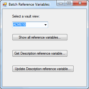

 Postconditions:
'  1. The Batch Reference Variables dialog box displays.
'     a. Select a vault view.
'     b. Click Show all reference variables.
'        1. In the Select Parent File dialog, select the assembly file identified
'           in Preconditions step 5 and click Open.
'        2. In the Select Child File dialog, select a part file referenced by the
'           assembly file and click Open.
'           Displays all of the reference variables for all configurations.
'        3. Click OK in the dialog box.
'     c. Click Get Description reference variable.
'        1.
'        2.
'           Displays the current value of reference variable, Description.
'     d. Click Update Description reference variable.
'        1.
'        2.
'        3. Type a new description and click OK.
'        4. Click OK in the dialog box.
'  2. Close the Batch Reference Variables dialog box.

    <System.Diagnostics.DebuggerStepThrough()> _
    Private Sub InitializeComponent()
        Me.VaultsComboBox = New System.Windows.Forms.ComboBox()
        Me.VaultsLabel = New System.Windows.Forms.Label()
        Me.Button1 = New System.Windows.Forms.Button()
        Me.Button2 = New System.Windows.Forms.Button()
        Me.Button3 = New System.Windows.Forms.Button()
        Me.SuspendLayout()
        'VaultsComboBox
        Me.VaultsComboBox.FormattingEnabled = True
        Me.VaultsComboBox.Location = New System.Drawing.Point(33, 43)
        Me.VaultsComboBox.Name = "VaultsComboBox"
        Me.VaultsComboBox.Size = New System.Drawing.Size(121, 21)
        Me.VaultsComboBox.TabIndex = 0
        'VaultsLabel
        Me.VaultsLabel.AutoSize = True
        Me.VaultsLabel.Location = New System.Drawing.Point(30, 18)
        Me.VaultsLabel.Name = "VaultsLabel"
        Me.VaultsLabel.Size = New System.Drawing.Size(100, 13)
        Me.VaultsLabel.TabIndex = 1
        Me.VaultsLabel.Text = "Select a vault view:"
        'Button1
        Me.Button1.Location = New System.Drawing.Point(33, 84)
        Me.Button1.Name = "Button1"
        Me.Button1.Size = New System.Drawing.Size(187, 23)
        Me.Button1.TabIndex = 2
        Me.Button1.Text = "Show all reference variables..."
        Me.Button1.UseVisualStyleBackColor = True
        'Button2
        Me.Button2.Location = New System.Drawing.Point(33, 138)
        Me.Button2.Name = "Button2"
        Me.Button2.Size = New System.Drawing.Size(187, 24)
        Me.Button2.TabIndex = 3
        Me.Button2.Text = "Get Description reference variable..."
        Me.Button2.UseVisualStyleBackColor = True
        'Button3
        Me.Button3.Location = New System.Drawing.Point(33, 190)
        Me.Button3.Name = "Button3"
        Me.Button3.Size = New System.Drawing.Size(208, 23)
        Me.Button3.TabIndex = 4
        Me.Button3.Text = "Update Description reference variable..."
        Me.Button3.UseVisualStyleBackColor = True
        'Form1
        Me.AutoScaleDimensions = New System.Drawing.SizeF(6.0!, 13.0!)
        Me.AutoScaleMode = System.Windows.Forms.AutoScaleMode.Font
        Me.ClientSize = New System.Drawing.Size(284, 262)
        Me.Controls.Add(Me.Button3)
        Me.Controls.Add(Me.Button2)
        Me.Controls.Add(Me.Button1)
        Me.Controls.Add(Me.VaultsLabel)
        Me.Controls.Add(Me.VaultsComboBox)
        Me.Name = "Form1"
        Me.Text = "Batch Reference Variables"
        Me.ResumeLayout(False)
        Me.PerformLayout()
    End Sub
