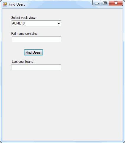

' Postconditions:
' 1. Displays the Find Users dialog box.
' a. Select a vault view.
' b. In Full name contains, type a substring of the full name of a
' user that exists in the vault.
' c. Click Find Users.
' A message box confirms the substring typed in Postconditions
' step 1b.
' d. Click OK.
' Displays a Search for users dialog.
' e. Click Find.
' Displays a Search for users dialog with results.
' f. Click the first row.
' g. Click Select.
' * Displays a message box with the updated user information.
' * The selected user's phone and website information are updated.
' h. Click OK.
' 2. Updates the Find Users dialog box with the full name and picture, if
' it exists, of the last user found whose full name contains the substring
' typed in Postconditions step 1b.
' 3. Close the Find Users dialog box.

Me.FindUsers = New System.Windows.Forms.Button()
Me.VaultsComboBox = New System.Windows.Forms.ComboBox()
Me.Label1 = New System.Windows.Forms.Label()
Me.Label2 = New System.Windows.Forms.Label()
Me.TextBox1 = New System.Windows.Forms.TextBox()
Me.Label3 = New System.Windows.Forms.Label()
Me.TextBox2 = New System.Windows.Forms.TextBox()
Me.SuspendLayout()
'FindUsers
Me.FindUsers.Location = New System.Drawing.Point(72, 136)
Me.FindUsers.Name = "FindUsers"
Me.FindUsers.Size = New System.Drawing.Size(66, 23)
Me.FindUsers.TabIndex = 0
Me.FindUsers.Text = "Find Users"
Me.FindUsers.TextAlign = System.Drawing.ContentAlignment.MiddleLeft
Me.FindUsers.UseVisualStyleBackColor = True
'VaultsComboBox
Me.VaultsComboBox.FormattingEnabled = True
Me.VaultsComboBox.Location = New System.Drawing.Point(30, 39)
Me.VaultsComboBox.Name = "VaultsComboBox"
Me.VaultsComboBox.Size = New System.Drawing.Size(169, 21)
Me.VaultsComboBox.TabIndex = 1
'Label1
Me.Label1.AutoSize = True
Me.Label1.Location = New System.Drawing.Point(27, 23)
Me.Label1.Name = "Label1"
Me.Label1.Size = New System.Drawing.Size(91, 13)
Me.Label1.TabIndex = 2
Me.Label1.Text = "Select vault view:"
'Label2
Me.Label2.AutoSize = True
Me.Label2.Location = New System.Drawing.Point(27, 77)
Me.Label2.Name = "Label2"
Me.Label2.Size = New System.Drawing.Size(104, 13)
Me.Label2.TabIndex = 3
Me.Label2.Text = "Full name contains:"
'TextBox1
Me.TextBox1.Location = New System.Drawing.Point(32, 93)
Me.TextBox1.Name = "TextBox1"
Me.TextBox1.Size = New System.Drawing.Size(167, 20)
Me.TextBox1.TabIndex = 4
'Label3
Me.Label3.AutoSize = True
Me.Label3.Location = New System.Drawing.Point(29, 172)
Me.Label3.Name = "Label3"
Me.Label3.Size = New System.Drawing.Size(83, 13)
Me.Label3.TabIndex = 6
Me.Label3.Text = "Last user found:"
'TextBox2
Me.TextBox2.Location = New System.Drawing.Point(30, 188)
Me.TextBox2.Name = "TextBox2"
Me.TextBox2.Size = New System.Drawing.Size(169, 20)
Me.TextBox2.TabIndex = 7
'Form1
Me.AutoScaleDimensions = New System.Drawing.SizeF(6.0!, 13.0!)
Me.AutoScaleMode = System.Windows.Forms.AutoScaleMode.Font
Me.ClientSize = New System.Drawing.Size(406, 447)
Me.Controls.Add(Me.TextBox2)
Me.Controls.Add(Me.Label3)
Me.Controls.Add(Me.TextBox1)
Me.Controls.Add(Me.Label2)
Me.Controls.Add(Me.Label1)
Me.Controls.Add(Me.VaultsComboBox)
Me.Controls.Add(Me.FindUsers)
Me.Name = "Form1"
Me.Text = "Find Users"
Me.ResumeLayout(False)
Me.PerformLayout()
End Sub
