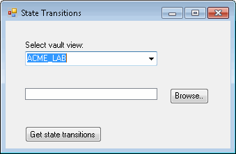

' Postconditions:
'  1. Displays the State Transitions dialog box.
'  2. Select a vault view.
'  3. Click Browse.
'  4. Displays the Select a file dialog box.
'     a. Click a file in the selected vault.
'     b. Click Open.
'     The selected file's path and file name appear
'     in the Select a file dialog box.
'  5. Click Get state transitions
'  6. Displays a message box showing the name of the selected
'     file and its current and next possible state transitions.
'  7. Click OK to close the message box.
'  8. Close the State Transitions dialog box.
