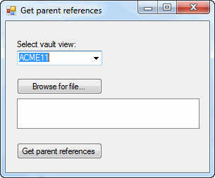

' 1. The Get parent references dialog displays.
' 2. Select a vault view.
' 3. Click Browse for file.
' 4. Locate and click one of the parts mentioned in Preconditions step 4.
' 5. Click Open.
' 6. Click Get parent references.
' 7. Displays the references of the selected part.
' 8. Click OK.
' 9. Close the Get parent references dialog.

        Me.Text = "Get parent references"
