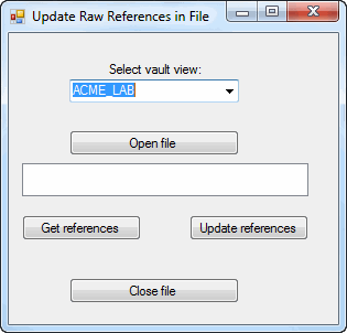

// Postconditions:
//  1. Displays the Update Raw References in File dialog box.
//  2. Select the vault view where the SOLIDWORKS assembly or
//     drawing document that you checked out in
//     Preconditions step 4 resides.
//  3. Click Open file.
//  4. Displays the Open a file dialog box.
//     a. Click the assembly or drawing document you checked out
//        in Preconditions step 4.
//     b. Click Open.
//     The opened file's path and file name appear
//     in the Update Raw References in File dialog box.
//  5. Click Get references.
//     a. Displays a message box for each referenced file.
//        The referenced file's ID, path and file name, file name,
//        type, and number of times referenced appear in the
//        message box.
//     b. Click OK to close each message box.
//  6. Rename one of the referenced files in the selected vault
//     in Windows Explorer.
//  7. Click Update references.
//     a. Displays a message box confirming that references were updated.
//     b. Click OK to close the message box.
//  8. Click Get references.
//        message box. Note that the renamed file is now a referenced
//        file of the open document.
//  9. Click Close file.
// 10. Click OK to close the message box confirming that the open
//     document was closed.
// 11. Close the Update Raw References in File dialog box.
// 12. Check in the SOLIDWORKS assembly or drawing document and
//     its file references.

            this.OpenButton.Click += new System.EventHandler(OpenButton_Click);
            // FileListBox
            this.FileListBox.FormattingEnabled = true;
            this.FileListBox.Location = new System.Drawing.Point(12, 96);
            this.FileListBox.Name = "FileListBox";
            this.FileListBox.Size = new System.Drawing.Size(235, 30);
            this.FileListBox.TabIndex = 3;
            // OpenFileDialog1
            this.OpenFileDialog1.FileName = "OpenFileDialog1";
            this.OpenFileDialog1.Multiselect = true;
            this.OpenFileDialog1.Title = "Open a file";
            // UpdateButton
            this.UpdateButton.Location = new System.Drawing.Point(139, 144);
            this.UpdateButton.Name = "UpdateButton";
            this.UpdateButton.Size = new System.Drawing.Size(108, 23);
            this.UpdateButton.TabIndex = 4;
            this.UpdateButton.Text = "Update references";
            this.UpdateButton.UseVisualStyleBackColor = true;
            this.UpdateButton.Click += new System.EventHandler(UpdateButton_Click);
            // GetButton
            this.GetButton.Location = new System.Drawing.Point(12, 144);
            this.GetButton.Name = "GetButton";
            this.GetButton.Size = new System.Drawing.Size(108, 23);
            this.GetButton.TabIndex = 5;
            this.GetButton.Text = "Get references";
            this.GetButton.UseVisualStyleBackColor = true;
            this.GetButton.Click += new System.EventHandler(GetButton_Click);
            // CloseButton
            this.CloseButton.Location = new System.Drawing.Point(74, 192);
            this.CloseButton.Name = "CloseButton";
            this.CloseButton.Size = new System.Drawing.Size(99, 23);
            this.CloseButton.TabIndex = 6;
            this.CloseButton.Text = "Close file";
            this.CloseButton.UseVisualStyleBackColor = true;
            this.CloseButton.Click += new System.EventHandler(CloseButton_Click);
            // Form1
            this.AutoScaleDimensions = new System.Drawing.SizeF(6F, 13F);
            this.AutoScaleMode = System.Windows.Forms.AutoScaleMode.Font;
            this.ClientSize = new System.Drawing.Size(266, 233);
            this.Controls.Add(this.CloseButton);
            this.Controls.Add(this.GetButton);
            this.Controls.Add(this.UpdateButton);
            this.Controls.Add(this.FileListBox);
            this.Controls.Add(this.OpenButton);
            this.Controls.Add(this.VaultsComboBox);
            this.Controls.Add(this.label1);
            this.Name = "Form1";
            this.Text = "Update Raw References in File";
            this.Load += new System.EventHandler(Form1_Load);
            this.ResumeLayout(false);
            this.PerformLayout();
        #endregion
        private System.Windows.Forms.Label label1;
        private System.Windows.Forms.ComboBox VaultsComboBox;
        private System.Windows.Forms.Button OpenButton;
        private System.Windows.Forms.ListBox FileListBox;
        private System.Windows.Forms.Button UpdateButton;
        private System.Windows.Forms.Button GetButton;
        private System.Windows.Forms.Button CloseButton;
        private System.Windows.Forms.OpenFileDialog OpenFileDialog1;
