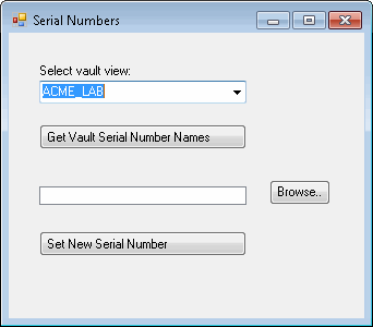

// 5. Click Debug > Start Debugging or press F5.
// Postconditions:
// 1. Displays the Serial Numbers dialog box.
// 2. Select a vault view.
// 3. Click Get Vault Serial Number Names.
// 4. Displays a message box containing the names of the serial number
// generators for the selected vault.
// 5. Click OK to close the message box.
// 6. Click Browse.
// a. Click a checked-out file in the selected vault whose
// data card has a Part Number variable.
// b. Click Open.
// The selected file's path and file name appear in the Serial
// Numbers dialog box.
// 7. Click Set New Serial Number.
// 8. Displays a message box verifying that the Part Number was
// set and shows the value of that Part Number.
// NOTES:
// * The value set for the Part Number is the next number in the first
// serial number generator shown in the message box displayed in
// step 3.
// * Make note of the Part Number.
// 9. Click OK to close the message box.
// 10. Check in the file whose Part Number was set in step 7, then check out the
// file.
// 11. Examine the Part Number on the data card of the checked-out file.
// 12. Close the Serial Numbers dialog box.

this.NewButton.Click += new System.EventHandler(this.NewButton_Click);
//Form1
this.AutoScaleDimensions = new System.Drawing.SizeF(6f, 13f);
this.AutoScaleMode = System.Windows.Forms.AutoScaleMode.Font;
this.ClientSize = new System.Drawing.Size(326, 262);
this.Controls.Add(this.NewButton);
this.Controls.Add(this.BrowseButton);
this.Controls.Add(this.FileListBox);
this.Controls.Add(this.Button1);
this.Controls.Add(this.VaultsComboBox);
this.Controls.Add(this.VaultsLabel);
this.Name = "Form1";
this.Text = "Serial Numbers";
this.Load += new System.EventHandler(this.Form1_Load);
this.ResumeLayout(false);
this.PerformLayout();
#endregion
internal System.Windows.Forms.Label VaultsLabel;
internal System.Windows.Forms.ComboBox VaultsComboBox;
internal System.Windows.Forms.Button Button1;
internal System.Windows.Forms.ListBox FileListBox;
internal System.Windows.Forms.Button BrowseButton;
internal System.Windows.Forms.Button NewButton;
internal System.Windows.Forms.OpenFileDialog OpenFileDialog1;
