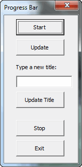

' Preconditions:
' 1. Create a VBA macro in SOLIDWORKS.
' 2. Right-click the macro project name in the Project Explorer and click
'    Insert > UserForm
' 3. Modify UserForm1 (UserForm) to look like this:
' 4. Copy Forms - UserForm1 into UserForm1 (Code).
' 5. Modify control_name in the control_name_Click subroutine names to
'    match your form.
' 6. Right-click the macro project name and click Insert > Module.
' 7. Copy Modules into the new module.
' Postconditions:
' 1. Shows a dialog box.
' 2. Click Start.
'    * A progress indicator appears on the SOLIDWORKS status bar.
'    * The progress indicator increments to 100% completion.
' 3. Click Update repeatedly to increment the progress indicator in steps of
'    10.
' 4. Inspect the Immediate window to see the return code after each update.
' 5. Type a new title and click Update Title.
'    * The progress indicator title changes.
' 6. Click Stop to remove the progress indicator from the SOLIDWORKS status bar.
' 7. Click Exit to close the dialog box.
