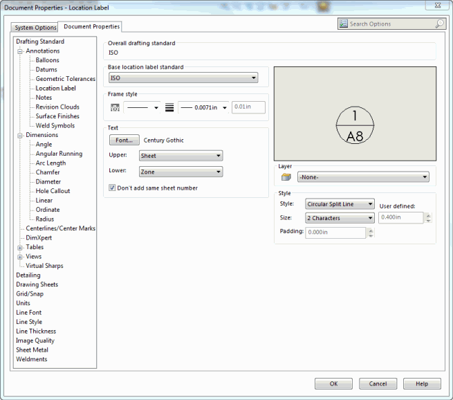

Document Properties > Annotations > Location Label
Setting
Get/Set Methods
Return Value or <Value>
Comments
Base location label standard
IModelDocExtension::GetUserPreferenceInteger(swUserPreferenceIntegerValue_e.swDetailingDimensionStandard, swUserPreferenceOption_e.swDetailingLocationLabel)
IModelDocExtension::SetUserPreferenceInteger(swUserPreferenceIntegerValue_e.swDetailingDimensionStandard, swUserPreferenceOption_e.swDetailingLocationLabel, swDetailingStandard_e.<Value>)
See swDetailingStandard_e for valid options
Specifies the standard to use for a location label
Frame style - Frame Style
IModelDocExtension::GetUserPreferenceInteger(swUserPreferenceIntegerValue_e.swDetailingLocationLabelFrameLineStyle, swUserPreferenceOption_e.swDetailingLocationLabel)
IModelDocExtension::SetUserPreferenceInteger(swUserPreferenceIntegerValue_e.swDetailingLocationLabelFrameLineStyle, swUserPreferenceOption_e.swDetailingLocationLabel, swLineStyles_e.<Value>)
See swLineStyles_e for valid options
Specifies the style of the frame of a location label
Frame style -  Frame Thickness
IModelDocExtension::GetUserPreferenceInteger(swUserPreferenceIntegerValue_e.swDetailingLocationLabelFrameLineThickness, swUserPreferenceOption_e.swDetailingLocationLabel)
IModelDocExtension::SetUserPreferenceInteger(swUserPreferenceIntegerValue_e.swDetailingLocationLabelFrameLineThickness, swUserPreferenceOption_e.swDetailingLocationLabel, swLineWeights_e.<Value>)
See swLineWeights_e for valid options
Specifies the thickness of the frame of a location label
Frame style - Custom Thickness
IModelDocExtension::GetUserPreferenceDouble(swUserPreferenceDoubleValue_e.swDetailingLocationLabelFrameLineThicknessCustom, swUserPreferenceOption_e.swDetailingLocationLabel)
IModelDocExtension::SetUserPreferenceDouble(swUserPreferenceDoubleValue_e.swDetailingLocationLabelFrameLineThicknessCustom, swUserPreferenceOption_e.swDetailingLocationLabel, <Value>)
Double value
Specifies the custom thickness of the lines of a location label frame
Layer
IModelDocExtension::GetUserPreferenceString(swUserPreferenceStringValue_e.swDetailingLayer, swUserPreferenceOption_e.swDetailingLocationLabel)
IModelDocExtension::SetUserPreferenceString(swUserPreferenceStringValue_e.swDetailingLayer, swUserPreferenceOption_e.swDetailingLocationLabel, <Value>)
String value
Specifies the name of the layer to which to apply these settings; this setting is available only in drawings
Style - Style
IModelDocExtension::GetUserPreferenceInteger(swUserPreferenceIntegerValue_e.swDetailingLocationLabelStyle, swUserPreferenceOption_e.swDetailingLocationLabel)
IModelDocExtension::SetUserPreferenceInteger(swUserPreferenceIntegerValue_e.swDetailingLocationLabelStyle, swUserPreferenceOption_e.swDetailingLocationLabel, swBalloonStyle_e.<Value>)
See swBalloonStyle_e for valid options
Specifies the style of a location label
Style - Size
IModelDocExtension::GetUserPreferenceInteger(swUserPreferenceIntegerValue_e.swDetailingLocationLabelFit, swUserPreferenceOption_e.swDetailingLocationLabel)
IModelDocExtension::SetUserPreferenceInteger(swUserPreferenceIntegerValue_e.swDetailingLocationLabelFit, swUserPreferenceOption_e.swDetailingLocationLabel, swBalloonFit_e.<Value>)
See swBalloonFit_e for valid options
Specifies the size of a location label
Style - User defined
IModelDocExtension::GetUserPreferenceDouble(swUserPreferenceDoubleValue_e.swDetailingLocationLabelStyleCustomSize, swUserPreferenceOption_e.swDetailingLocationLabel)
IModelDocExtension::SetUserPreferenceDouble(swUserPreferenceDoubleValue_e.swDetailingLocationLabelStyleCustomSize, swUserPreferenceOption_e.swDetailingLocationLabel, <Value>)
Double value
Specifies a user-defined size of a location label
Style - Padding
IModelDocExtension::GetUserPreferenceDouble(swUserPreferenceDoubleValue_e.swDetailingLocationLabelPadding, swUserPreferenceOption_e.swDetailingLocationLabel)
IModelDocExtension::SetUserPreferenceDouble(swUserPreferenceDoubleValue_e.swDetailingLocationLabelPadding, swUserPreferenceOption_e.swDetailingLocationLabel, <Value>)
Double value
Specifies the size of the extra padding inside tight-fit borders for a location label
Text - Font
IModelDocExtension::GetUserPreferenceTextFormat(swUserPreferenceTextFormat_e.swDetailingLocationLabelTextFormat, swUserPreferenceOption_e.swDetailingLocationLabel)
IModelDocExtension::SetUserPreferenceTextFormat(swUserPreferenceTextFormat_e.swDetailingLocationLabelTextFormat, swUserPreferenceOption_e.swDetailingLocationLabel, <Value>)
See ITextFormat for valid font options
To set font property values, implement ITextFormat, set the appropriate ITextFormat member values, and pass the ITextFormat object in the set method
Text - Upper
IModelDocExtension::GetUserPreferenceInteger(swUserPreferenceIntegerValue_e.swDetailingLocationLabelUpperText, swUserPreferenceOption_e.swDetailingLocationLabel)
IModelDocExtension::SetUserPreferenceInteger(swUserPreferenceIntegerValue_e.swDetailingLocationLabelUpperText, swUserPreferenceOption_e.swDetailingLocationLabel, swLocationLabelText_e.<Value>)
See swLocationLabelText_e for valid options
Specifies the text for the upper section of a location label
Text - Lower
IModelDocExtension::GetUserPreferenceInteger(swUserPreferenceIntegerValue_e.swDetailingLocationLabelLowerText, swUserPreferenceOption_e.swDetailingLocationLabel)
IModelDocExtension::SetUserPreferenceInteger(swUserPreferenceIntegerValue_e.swDetailingLocationLabelLowerText, swUserPreferenceOption_e.swDetailingLocationLabel, swLocationLabelText_e.<Value>)
Specifies the text for the lower section of a location label
Text - Don't add same sheet number
IModelDocExtension::GetUserPreferenceToggle(swUserPreferenceToggle_e.swDetailingLocationLabelAddSameSheetNumber, swUserPreferenceOption_e.swDetailingLocationLabel)
IModelDocExtension::SetUserPreferenceToggle(swUserPreferenceToggle_e.swDetailingLocationLabelAddSameSheetNumber, swUserPreferenceOption_e.swDetailingLocationLabel, <Value>)
Boolean value
Specifies whether to add the same sheet number to a location label
