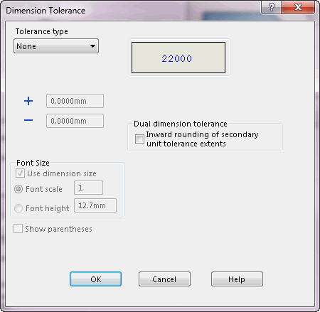

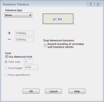

Document Properties > Dimensions  > Dimension Tolerance
The dialog above appears when the Tolerance button is clicked on the following document property pages:
Document Properties page

Substitute <UserPrefOption> in the methods following to get and set the dimension tolerance settings for a given dimension document property.
Setting
Get/Set Methods
Return Value or <Value>
Comments
Tolerance type
IModelDocExtension::GetUserPreferenceInteger(swUserPreferenceIntegerValue_e.swDetailingToleranceStyle, swUserPreferenceOption_e.<UserPrefOption>)
IModelDocExtension::SetUserPreferenceInteger(swUserPreferenceIntegerValue_e.swDetailingToleranceStyle, swUserPreferenceOption_e.<UserPrefOption>, swTolType_e.<Value>)
See swTolType_e for valid options
Maximum tolerance value
IModelDocExtension::GetUserPreferenceDouble(swUserPreferenceDoubleValue_e.swDetailingMaxToleranceValue, swUserPreferenceOption_e.<UserPrefOption>)
IModelDocExtension::SetUserPreferenceDouble(swUserPreferenceDoubleValue_e.swDetailingMaxToleranceValue, swUserPreferenceOption_e.<UserPrefOption>, <Value>)
Double value
Specifies the maximum tolerance for dimensions in a drawing document
Minimum tolerance value
IModelDocExtension::GetUserPreferenceDouble(swUserPreferenceDoubleValue_e.swDetailingMinToleranceValue, swUserPreferenceOption_e.<UserPrefOption>)
IModelDocExtension::SetUserPreferenceDouble(swUserPreferenceDoubleValue_e.swDetailingMinToleranceValue, swUserPreferenceOption_e.<UserPrefOption>, <Value>)
Double value
Specifies the minimum tolerance for dimensions in a drawing document
Dual dimension tolerance - Inward rounding of secondary unit tolerance extents
IModelDocExtension::GetUserPreferenceToggle(swUserPreferenceToggle_e.swDetailingDimensionsToleranceInwardRounding, swUserPreferenceOption_e.<UserPrefOption>)
IModelDocExtension::SetUserPreferenceToggle(swUserPreferenceToggle_e.swDetailingDimensionsToleranceInwardRounding, swUserPreferenceOption_e.<UserPrefOption>, <Value>)
Boolean value
Specifies whether to set the limits of the secondary unit's tolerance range to fit within the tolerance range of the primary unit by using inward rounding so that the dual dimension does not conflict with the primary dimension
Font - Use dimension font
IModelDocExtension::GetUserPreferenceToggle(swUserPreferenceToggle_e.swDetailingDimensionsToleranceUseDimensionFont, swUserPreferenceOption_e.<UserPrefOption>)
IModelDocExtension::SetUserPreferenceToggle(swUserPreferenceToggle_e.swDetailingDimensionsToleranceUseDimensionFont, swUserPreferenceOption_e.<UserPrefOption>, <Value>)
Boolean value
Specifies whether to change font size for dimension tolerance text
Font - Size by scale or height
IModelDocExtension::GetUserPreferenceInteger(swUserPreferenceIntegerValue_e.swDetailingToleranceTextSizing, swUserPreferenceOption_e.<UserPrefOption>)
IModelDocExtension::SetUserPreferenceInteger(swUserPreferenceIntegerValue_e.swDetailingToleranceTextSizing, swUserPreferenceOption_e.<UserPrefOption>, swDetailingToleranceTextSizing_e.<Value>)
See swDetailingToleranceTextSizing_e for valid options; depending on the option chosen, also set either font scale value or font height value
Specifies how to size the tolerance text
Font - Font scale value
IModelDocExtension::GetUserPreferenceDouble(swUserPreferenceDoubleValue_e.swDetailingToleranceTextScale, swUserPreferenceOption_e.<UserPrefOption>)
IModelDocExtension::SetUserPreferenceDouble(swUserPreferenceDoubleValue_e.swDetailingToleranceTextScale, swUserPreferenceOption_e.<UserPrefOption>, <Value>)
Double value (0 - 10.0)
Specifies value to scale tolerance font
Font - Font height value
IModelDocExtension::GetUserPreferenceDouble(swUserPreferenceDoubleValue_e.swDetailingToleranceTextHeight, swUserPreferenceOption_e.<UserPrefOption>)
IModelDocExtension::SetUserPreferenceDouble(swUserPreferenceDoubleValue_e.swDetailingToleranceTextHeight, swUserPreferenceOption_e.<UserPrefOption>, <Value>)
Double value in meters
Specifies height of tolerance font
Fit tolerance font - Use dimension font
IModelDocExtension::GetUserPreferenceToggle(swUserPreferenceToggle_e.swDetailingDimensionsToleranceFitToUseDimensionFont, swUserPreferenceOption_e.<UserPrefOption>)
IModelDocExtension::SetUserPreferenceToggle(swUserPreferenceToggle_e.swDetailingDimensionsToleranceFitToUseDimensionFont, swUserPreferenceOption_e.<UserPrefOption>, <Value>)
Boolean value
For Fit and Fit-with-tolerance tolerance types only; specifies whether to use dimension tolerance text
Fit tolerance font - Size by scale or height
IModelDocExtension::GetUserPreferenceInteger(swUserPreferenceIntegerValue_e.swDetailingToleranceFitTolTextSizing, swUserPreferenceOption_e.<UserPrefOption>)
IModelDocExtension::SetUserPreferenceInteger(swUserPreferenceIntegerValue_e.swDetailingToleranceFitTolTextSizing, swUserPreferenceOption_e.<UserPrefOption>, swDetailingToleranceTextSizing_e.<Value>)
See swDetailingToleranceTextSizing_e for valid options; depending on the option chosen, also set either fit tolerance font scale value or font height value
For Fit and Fit-with-tolerance tolerance types only; specifies how to size the fit tolerance text
Fit tolerance font - Font scale
IModelDocExtension::GetUserPreferenceDouble(swUserPreferenceDoubleValue_e.swDetailingToleranceFitTolTextScale, swUserPreferenceOption_e.<UserPrefOption>)
IModelDocExtension::SetUserPreferenceDouble(swUserPreferenceDoubleValue_e.swDetailingToleranceFitTolTextScale, swUserPreferenceOption_e.<UserPrefOption>, <Value>)
For Fit and Fit-with-tolerance tolerance types only; specifies scale for fit tolerance font
Fit tolerance font - Font height
IModelDocExtension::GetUserPreferenceDouble(swUserPreferenceDoubleValue_e.swDetailingToleranceFitTolTextHeight, swUserPreferenceOption_e.<UserPrefOption>)
IModelDocExtension::SetUserPreferenceDouble(swUserPreferenceDoubleValue_e.swDetailingToleranceFitTolTextHeight, swUserPreferenceOption_e.<UserPrefOption>, <Value>)
For Fit and Fit-with-tolerance tolerance types only; specifies height of fit tolerance font
Show parentheses
IModelDocExtension::GetUserPreferenceToggle(swUserPreferenceToggle_e.swDetailingDimensionsToleranceUseParentheses, swUserPreferenceOption_e.<UserPrefOption>)
IModelDocExtension::SetUserPreferenceToggle(swUserPreferenceToggle_e.swDetailingDimensionsToleranceUseParentheses, swUserPreferenceOption_e.<UserPrefOption>, <Value>)
Boolean value
For Bilateral, Symmetric, or Fit-with-tolerance tolerance types only; specifies whether to show parentheses around linear tolerances
Fit tolerance display
IModelDocExtension::GetUserPreferenceInteger(swUserPreferenceIntegerValue_e.swDetailingToleranceFitTolDisplay, swUserPreferenceOption_e.<UserPrefOption>)
IModelDocExtension::SetUserPreferenceInteger(swUserPreferenceIntegerValue_e.swDetailingToleranceFitTolDisplay, swUserPreferenceOption_e.<UserPrefOption>, swFitTolDisplay_e.<Value>)
See swFitTolDisplay_e for valid options
