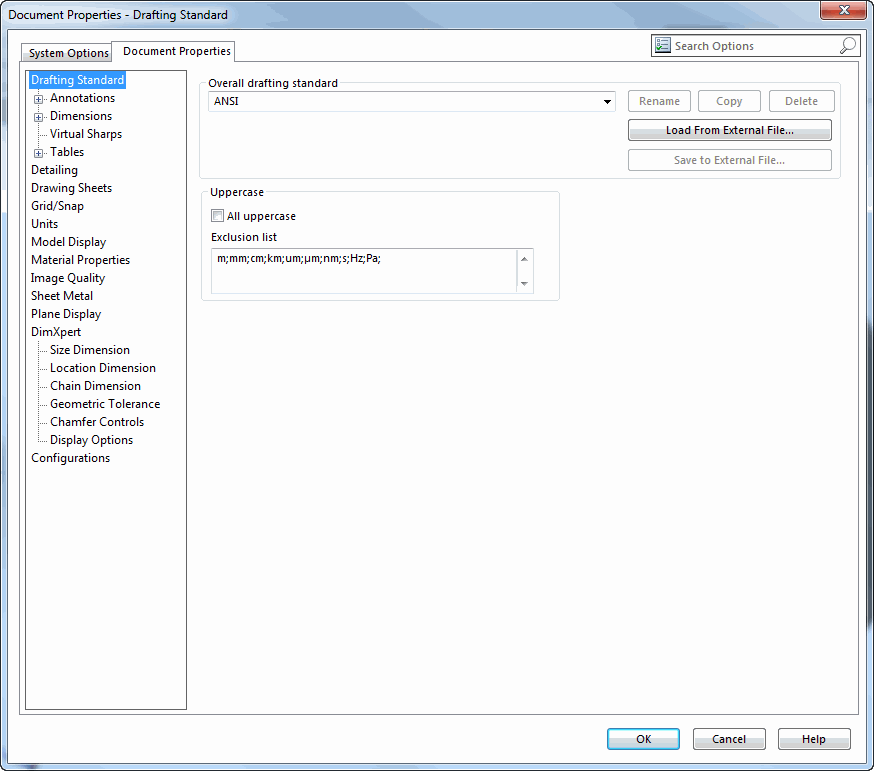

Overall drafting standard |
IModelDocExtension::GetUserPreferenceInteger(swUserPreferenceIntegerValue_e.swDetailingDimensionStandard,
swUserPreferenceOption_e.swDetailingNoOptionSpecified)
IModelDocExtension::SetUserPreferenceInteger(swUserPreferenceIntegerValue_e.swDetailingDimensionStandard,
swUserPreferenceOption_e.swDetailingNoOptionSpecified, swDetailingStandard_e.<Value>) |
See swDetailingStandard_e
for valid options |
Specifies the base drafting standard to use
Uppercase - All uppercase |
IModelDocExtension::GetUserPreferenceToggle(swUserPreferenceToggle_e.swDraftingStandardUppercase,
IModelDocExtension::SetUserPreferenceToggle(swUserPreferenceToggle_e.swDraftingStandardUppercase,
swUserPreferenceOption_e.swDetailingNoOptionSpecified, <Value>) |
Boolean value |
Specifies whether to set the drafting standard to all uppercase |
Uppercase - Exclusion list |
IModelDocExtension::GetUserPreferenceString(swUserPreferenceStringValue_e.swDraftStandardExclusionList,
IModelDocExtension::SetUserPreferenceString(swUserPreferenceStringValue_e.swDraftStandardExclusionList,
String value |
Specifies the list of strings to exclude from making uppercase |
