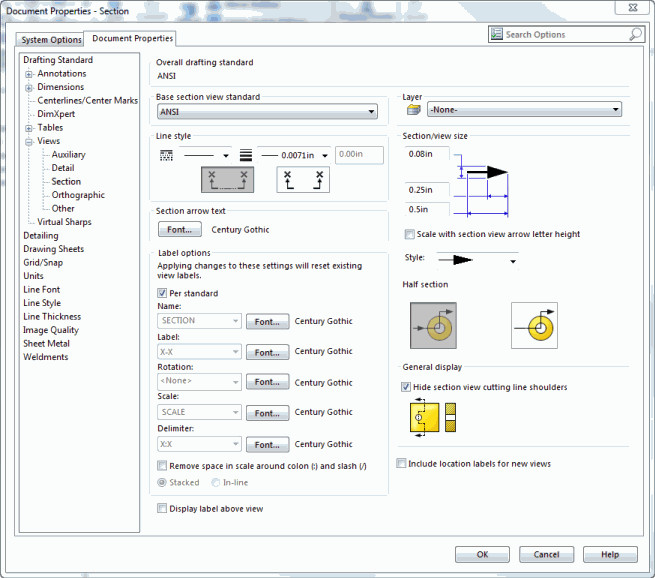

Document Properties > Views > Section
This topic contains two tables. The information in the table:
  • appearing immediately after the screen capture of the Document Properties - Section dialog corresponds to the settings on that dialog.
  • titled Obsolete Enumerators contains enumerators that previously appeared on the Document Properties - Section dialog, but are now obsolete and no longer appear on that dialog.
Enumerator
Comment
swDetailingSectionLabelTextFormat
Obsolete.
Use swDetailingSectionLabelNameTextFormat, swDetailingSectionLabelLabelTextFormat, swDetailingSectionLabelScaleTextFormat, or swDetailingSectionLabelDelimiterTextFormat
