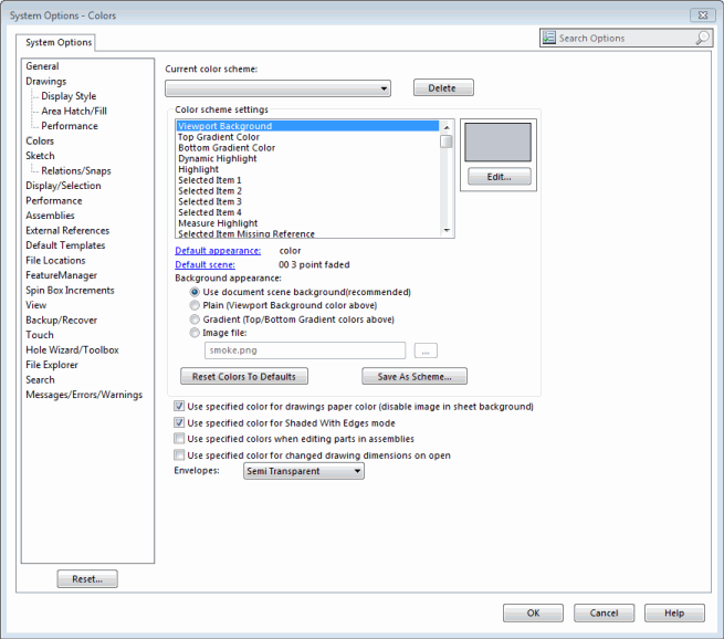

System Options > Colors
This topic contains two tables. The information in the table:
  • appearing immediately after the screen capture of the System Options - Colors dialog corresponds to the settings on that dialog.
  • titled Obsolete Enumerators contains enumerators that previously appeared on the System Options - Colors dialog, but are now obsolete and no longer appear on that dialog.
NOTE: The input or output value is the corresponding IColorTable value unless otherwise specified.

Color scheme settings - Assembly, Edit Part
ISldWorks::GetUserPreferenceIntegerValue(swUserPreferenceIntegerValue_e.swSystemColorsAssemblyEditPart)
ISldWorks::SetUserPreferenceIntegerValue(swUserPreferenceIntegerValue_e.swSystemColorsAssemblyEditPart, <Value>)
Integer value
COLORREF value in SOLIDWORKS IColorTable
Color scheme settings - Assembly, Hidden Lines of Edit Part
ISldWorks::GetUserPreferenceIntegerValue(swUserPreferenceIntegerValue_e.swSystemColorsAssemblyEditPartHiddenLines)
ISldWorks::SetUserPreferenceIntegerValue(swUserPreferenceIntegerValue_e.swSystemColorsAssemblyEditPartHiddenLines, <Value>)
Integer value
Color scheme settings - Assembly, Non-Edit Parts
ISldWorks::GetUserPreferenceIntegerValue(swUserPreferenceIntegerValue_e.swSystemColorsAssemblyNonEditPart)
ISldWorks::SetUserPreferenceIntegerValue(swUserPreferenceIntegerValue_e.swSystemColorsAssemblyNonEditPart, <Value>)
Integer value
Color scheme settings - Inactive Entities
ISldWorks::GetUserPreferenceIntegerValue(swUserPreferenceIntegerValue_e.swSystemColorsInactiveEntity)
ISldWorks::SetUserPreferenceIntegerValue(swUserPreferenceIntegerValue_e.swSystemColorsInactiveEntity, <Value>)
Integer value
Color scheme settings - Inactive Handles
ISldWorks::GetUserPreferenceIntegerValue(swUserPreferenceIntegerValue_e.swSystemColorsInactiveHandles)
ISldWorks::SetUserPreferenceIntegerValue(swUserPreferenceIntegerValue_e.swSystemColorsInactiveHandles, <Value>)
Integer value
Color scheme settings - Temporary Graphics
ISldWorks::GetUserPreferenceIntegerValue(swUserPreferenceIntegerValue_e.swSystemColorsTemporaryGraphics)
ISldWorks::SetUserPreferenceIntegerValue(swUserPreferenceIntegerValue_e.swSystemColorsTemporaryGraphics, <Value>)
Integer value
Color scheme settings - Temporary Graphics, Shaded
ISldWorks::GetUserPreferenceIntegerValue(swUserPreferenceIntegerValue_e.swSystemColorsTemporaryGraphicsShaded)
ISldWorks::SetUserPreferenceIntegerValue(swUserPreferenceIntegerValue_e.swSystemColorsTemporaryGraphicsShaded, <Value>)
Integer value
Color scheme settings - Sheet Metal Temporary Graphics color
ISldWorks::GetUserPreferenceIntegerValue(swUserPreferenceIntegerValue_e.swSystemColorsSheetMetalTemporaryGraphics)
ISldWorks::SetUserPreferenceIntegerValue(swUserPreferenceIntegerValue_e.swSystemColorsSheetMetalTemporaryGraphics, <Value>)
Integer value
Color scheme settings - Surfaces, Open Edges
ISldWorks::GetUserPreferenceIntegerValue(swUserPreferenceIntegerValue_e.swSystemColorsSurfacesOpenEdge)
ISldWorks::SetUserPreferenceIntegerValue(swUserPreferenceIntegerValue_e.swSystemColorsSurfacesOpenEdge, <Value>)
Integer value
Color scheme settings - Edges in Shaded With Edges Mode
ISldWorks::GetUserPreferenceIntegerValue(swUserPreferenceIntegerValue_e.swSystemColorsShadedEdge)
ISldWorks::SetUserPreferenceIntegerValue(swUserPreferenceIntegerValue_e.swSystemColorsShadedEdge, <Value>)
Integer value
Color scheme settings - Feature Tree, Normal Item
ISldWorks::GetUserPreferenceIntegerValue(swUserPreferenceIntegerValue_e.swSystemColorsTreeItemNormal)
ISldWorks::SetUserPreferenceIntegerValue(swUserPreferenceIntegerValue_e.swSystemColorsTreeItemNormal, <Value>)
Integer value
Color scheme settings - Feature Tree, Selected Item
ISldWorks::GetUserPreferenceIntegerValue(swUserPreferenceIntegerValue_e.swSystemColorsTreeItemSelected)
ISldWorks::SetUserPreferenceIntegerValue(swUserPreferenceIntegerValue_e.swSystemColorsTreeItemSelected, <Value>)
Integer value
Color scheme settings - Annotations, Imported
ISldWorks::GetUserPreferenceIntegerValue(swUserPreferenceIntegerValue_e.swSystemColorsImportedAnnotation)
ISldWorks::SetUserPreferenceIntegerValue(swUserPreferenceIntegerValue_e.swSystemColorsImportedAnnotation, <Value>)
Integer value
Color scheme settings - Annotations, Non Imported
ISldWorks::GetUserPreferenceIntegerValue(swUserPreferenceIntegerValue_e.swSystemColorsNonImportedAnnotation)
ISldWorks::SetUserPreferenceIntegerValue(swUserPreferenceIntegerValue_e.swSystemColorsNonImportedAnnotation, <Value>)
Integer value
Color scheme settings - Assembly Interference Volume
ISldWorks::GetUserPreferenceIntegerValue(swUserPreferenceIntegerValue_e.swSystemColorsAsmInterferenceVolume)
ISldWorks::SetUserPreferenceIntegerValue(swUserPreferenceIntegerValue_e.swSystemColorsAsmInterferenceVolume, <Value>)
Integer value
Color scheme settings - Hidden Edge Selection Show Color
ISldWorks::GetUserPreferenceIntegerValue(swUserPreferenceIntegerValue_e.swSystemColorsHiddenEdgeSelectionShow)
ISldWorks::SetUserPreferenceIntegerValue(swUserPreferenceIntegerValue_e.swSystemColorsHiddenEdgeSelectionShow, <Value>)
Integer value
Read-only COLORREF value in SOLIDWORKS IColorTable; although it appears that you have set it, the SOLIDWORKS software ignores your setting
Color scheme settings - Mate Callout, Healthy
ISldWorks::GetUserPreferenceIntegerValue(swUserPreferenceIntegerValue_e.swSystemColorsMateCalloutHealthy)
ISldWorks::SetUserPreferenceIntegerValue(swUserPreferenceIntegerValue_e.swSystemColorsMateCalloutHealthy, <Value>)
Integer value
Color scheme settings - Mate Callout, Warning
ISldWorks::GetUserPreferenceIntegerValue(swUserPreferenceIntegerValue_e.swSystemColorsMateCalloutWarning)
ISldWorks::SetUserPreferenceIntegerValue(swUserPreferenceIntegerValue_e.swSystemColorsMateCalloutWarning, <Value>)
Integer value
Color scheme settings -Mate Callout, Error
ISldWorks::GetUserPreferenceIntegerValue(swUserPreferenceIntegerValue_e.swSystemColorsMateCalloutError)
ISldWorks::SetUserPreferenceIntegerValue(swUserPreferenceIntegerValue_e.swSystemColorsMateCalloutError, <Value>)
Integer value COLORREF value in SOLIDWORKS IColorTable
Color scheme settings - Envelope Components
ISldWorks::GetUserPreferenceIntegerValue(swUserPreferenceIntegerValue_e.swEnvelopeComponentColor)
ISldWorks::SetUserPreferenceIntegerValue(swUserPreferenceIntegerValue_e.swEnvelopeComponentColor, <Value>)
Integer value
Color scheme settings - Assembly Visualization First
ISldWorks::GetUserPreferenceIntegerValue(swUserPreferenceIntegerValue_e.swAssemblyVisualizationComponentColor1)
ISldWorks::SetUserPreferenceIntegerValue(swUserPreferenceIntegerValue_e.sswAssemblyVisualizationComponentColor1, <Value>)
Color scheme settings - Assembly Visualization Second
ISldWorks::GetUserPreferenceIntegerValue(swUserPreferenceIntegerValue_e.swAssemblyVisualizationComponentColor2)
ISldWorks::SetUserPreferenceIntegerValue(swUserPreferenceIntegerValue_e.swAssemblyVisualizationComponentColor2, <Value>)
Color scheme settings - Assembly Visualization Third
ISldWorks::GetUserPreferenceIntegerValue(swUserPreferenceIntegerValue_e.swAssemblyVisualizationComponentColor3)
ISldWorks::SetUserPreferenceIntegerValue(swUserPreferenceIntegerValue_e.swAssemblyVisualizationComponentColor3, <Value>)
Color scheme settings - Assembly Visualization Fourth
ISldWorks::GetUserPreferenceIntegerValue(swUserPreferenceIntegerValue_e.swAssemblyVisualizationComponentColor4)
ISldWorks::SetUserPreferenceIntegerValue(swUserPreferenceIntegerValue_e.swAssemblyVisualizationComponentColor4, <Value>)
Color scheme settings - Assembly Visualization Fifth
ISldWorks::GetUserPreferenceIntegerValue(swUserPreferenceIntegerValue_e.swAssemblyVisualizationComponentColor5)
ISldWorks::SetUserPreferenceIntegerValue(swUserPreferenceIntegerValue_e.swAssemblyVisualizationComponentColor5, <Value>)
Color scheme settings - Assembly Visualization Sixth
ISldWorks::GetUserPreferenceIntegerValue(swUserPreferenceIntegerValue_e.swAssemblyVisualizationComponentColor6)
ISldWorks::SetUserPreferenceIntegerValue(swUserPreferenceIntegerValue_e.swAssemblyVisualizationComponentColor6, <Value>)
Color scheme settings - Annotations, DimXpert
ISldWorks::GetUserPreferenceIntegerValue(swUserPreferenceIntegerValue_e.swSystemColorsSwiftAnnotations)
ISldWorks::SetUserPreferenceIntegerValue(swUserPreferenceIntegerValue_e.swSystemColorsSwiftAnnotations, <Value>)
Integer value
Color scheme settings - DimXpert, Under Constrained
ISldWorks::GetUserPreferenceIntegerValue(swUserPreferenceIntegerValue_e.swSystemColorsSwiftUnderConstrained)
ISldWorks::SetUserPreferenceIntegerValue(swUserPreferenceIntegerValue_e.swSystemColorsSwiftUnderConstrained, <Value>)
Integer value
Color scheme settings - DimXpert, Fully Constrained
ISldWorks::GetUserPreferenceIntegerValue(swUserPreferenceIntegerValue_e.swSystemColorsSwiftFullyConstrained)
ISldWorks::SetUserPreferenceIntegerValue(swUserPreferenceIntegerValue_e.swSystemColorsSwiftFullyConstrained, <Value>)
Integer value
Color scheme settings - DimXpert, Over Constrained
ISldWorks::GetUserPreferenceIntegerValue(swUserPreferenceIntegerValue_e.swSystemColorsSwiftOverConstrained)
ISldWorks::SetUserPreferenceIntegerValue(swUserPreferenceIntegerValue_e.swSystemColorsSwiftOverConstrained, <Value>)
Integer value
Color scheme settings - Annotations, TolAnalyst Dimension
ISldWorks::GetUserPreferenceIntegerValue(swUserPreferenceIntegerValue_e.swSystemColorsToleranceAnalysisDim)
ISldWorks::SetUserPreferenceIntegerValue(swUserPreferenceIntegerValue_e.swSystemColorsToleranceAnalysisDim, <Value>)
Integer value
Background appearance:  Use document scene background
ISldWorks::GetUserPreferenceIntegerValue(swUserPreferenceIntegerValue_e.swColorsBackgroundAppearance)
ISldWorks::SetUserPreferenceIntegerValue(swUserPreferenceIntegerValue_e.swColorsBackgroundAppearance, swColorsBackgroundAppearance_e.swColorsBackgroundAppearance_DocumentScene)
See swColorsBackgroundAppearance_e for valid options
Background appearance:  Plain (Viewport Background color above)
ISldWorks::SetUserPreferenceIntegerValue(swUserPreferenceIntegerValue_e.swColorsBackgroundAppearance, swColorsBackgroundAppearance_e.swColorsBackgroundAppearance_Plain)
Background appearance:  Gradient (Top/Bottom Gradient colors above)
ISldWorks::SetUserPreferenceIntegerValue(swUserPreferenceIntegerValue_e.swColorsBackgroundAppearance, swColorsBackgroundAppearance_e.swColorsBackgroundAppearance_Gradient)
Background appearance: Image File
ISldWorks::SetUserPreferenceIntegerValue(swUserPreferenceIntegerValue_e.swColorsBackgroundAppearance, swColorsBackgroundAppearance_e.swColorsBackgroundAppearance_Image)
and
ISldWorks::GetUserPreferenceStringValue(swUserPreferenceStringValue_e.swColorsBackgroundImageFile)
ISldWorks::GetUserPreferenceStringValue(swUserPreferenceStringValue_e.swColorsBackgroundImageFile, <Value>)
Integer value:
String value:
Path and file name of the file to use as the background for the SOLIDWORKS graphics window
NOTE: If you omit the path, then the default image folder in the SOLIDWORKS install folder is assumed:
\data\Images\textures\background
You can also use ISldWorks::GetDataFolder to get the data folder
Use specified color for drawings paper color
ISldWorks::GetUserPreferenceToggle(swUserPreferenceToggle_e.swDrawingSheetBackgroundAsPicture)
ISldWorks::SetUserPreferenceToggle(swUserPreferenceToggle_e.swDrawingSheetBackgroundAsPicture, <OnFlag>)
Boolean value
Use specified color for Shaded With Edges mode
ISldWorks::GetUserPreferenceToggle(swUserPreferenceToggle_e.swColorsUseShadedEdgeColor)
ISldWorks::SetUserPreferenceToggle(swUserPreferenceToggle_e.swColorsUseShadedEdgeColor, <OnFlag>)
Boolean value
Specifies whether to use specified colors for Shaded With Edges mode
Use specified colors when editing parts in assemblies
ISldWorks::GetUserPreferenceToggle(swUserPreferenceToggle_e.swColorsUseSpecifiedEditColors)
ISldWorks::SetUserPreferenceToggle(swUserPreferenceToggle_e.swColorsUseSpecifiedEditColors, <OnFlag>)
Boolean value
Specifies whether to use specified colors when editing assemblies
Use specified color for changed drawing dimensions on open
ISldWorks::GetUserPreferenceToggle(swUserPreferenceToggle_e.swUseChangedDimensions)
ISldWorks::SetUserPreferenceToggle(swUserPreferenceToggle_e.swUseChangedDimensions, <OnFlag>)
Boolean value
Specifies whether to highlight changed dimensions in a  specified color after a drawing document is opened
Envelopes
ISldWorks::GetUserPreferenceIntegerValue(swUserPreferenceIntegerValue_e.swSystemColorsEnvelopes)
ISldWorks::SetUserPreferenceIntegerValue(swUserPreferenceIntegerValue_e.swSystemColorsEnvelopes, swSystemColorsEnvelopes_e.<Value>)
See swSystemColorsEnvelopes_e for valid options
Enumerator
Comment
swColorsGradientPartBackground
Obsolete; used swColorsBackgroundAppearance_e
swColorsMatchViewAndFeatureManagerBackground
Obsolete
swSystemColorsDrawingsPaperBorder
Obsolete
swSystemColorsDrawingsPaperShadow
Obsolete
swSystemColorsPropertyManagerColor
Obsolete; used swPropertyManagerColorScheme_e
swSystemColorsRefTriadX
Obsolete
swSystemColorsRefTriadY
Obsolete
swSystemColorsRefTriadZ
Obsolete
