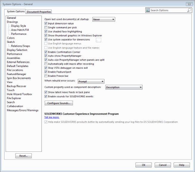

This topic contains two tables. The information in the table:
  • appearing immediately after the screen capture of the System Options - General dialog corresponds to the settings on that dialog.

Setting
Get/Set Methods
Return Value
or
<Value>
or
<OnFlag>
Comment
Open last used document(s) at startup
ISldWorks::GetUserPreferenceToggle(swUserPreferenceToggle_e.swOpenLastUsedDocumentAtStart)
ISldWorks::SetUserPreferenceToggle(swUserPreferenceToggle_e.swOpenLastUsedDocumentAtStart, <OnFlag>)
Boolean value
Specifies whether to open the last-used document when starting up SOLIDWORKS software
Input dimension value
ISldWorks::GetUserPreferenceToggle(swUserPreferenceToggle_e.swInputDimValOnCreate)
ISldWorks::SetUserPreferenceToggle(swUserPreferenceToggle_e.swInputDimValOnCreate, <OnFlag>)
Boolean value
Specifies whether to automatically display Modify dialog when dimensioning new entities
Single command per pick
ISldWorks::GetUserPreferenceToggle(swUserPreferenceToggle_e.swSingleCommandPerPick)
ISldWorks::SetUserPreferenceToggle(swUserPreferenceToggle_e.swSingleCommandPerPick, <OnFlag>)
Boolean value
Specifies whether to deselect sketch and dimension tools after each use
Use shaded face highlighting
ISldWorks::GetUserPreferenceToggle(swUserPreferenceToggle_e.swUseShadedFaceHighlight)
ISldWorks::SetUserPreferenceToggle(swUserPreferenceToggle_e.swUseShadedFaceHighlight, <OnFlag>)
Boolean value
Specifies whether selected faces are displayed in a solid color (green by default)
Show thumbnail graphics in Windows Explorer
ISldWorks::GetUserPreferenceToggle(swUserPreferenceToggle_e.swThumbnailGraphics)
ISldWorks::SetUserPreferenceToggle(swUserPreferenceToggle_e.swThumbnailGraphics, <OnFlag>)
Boolean value
Specifies whether thumbnail graphic instead of an icon in Windows Explorer is displayed for each SOLIDWORKS part or assembly document
Use system separator for dimensions
ISldWorks::GetUserPreferenceToggle(swUserPreferenceToggle_e.swUseSystemSeparatorForDims)
ISldWorks::SetUserPreferenceToggle(swUserPreferenceToggle_e.swUseSystemSeparatorForDims, <OnFlag>)
Boolean value
Specifies whether default system decimal separator is used when displaying decimal numbers
Use English language menus
ISldWorks::GetUserPreferenceToggle(swUserPreferenceToggle_e.swUseEnglishLanguage)
ISldWorks::SetUserPreferenceToggle(swUserPreferenceToggle_e.swUseEnglishLanguage, <OnFlag>)
Boolean value
Specifies whether to change to English if another language was selected when SOLIDWORKS software was installed;  SOLIDWORKS software must be restarted for this change to take effect
Use English language feature and file names
ISldWorks::GetUserPreferenceToggle(swUserPreferenceToggle_e.swUseEnglishLanguageFeatureNames)
ISldWorks::SetUserPreferenceToggle(swUserPreferenceToggle_e.swUseEnglishLanguageFeatureNames, <OnFlag>)
Boolean value
Specifies whether to use English feature and file names in languages other than English
Enable Confirmation Corner
ISldWorks::GetUserPreferenceToggle(swUserPreferenceToggle_e.swEnableConfirmationCorner)
ISldWorks::SetUserPreferenceToggle(swUserPreferenceToggle_e.swEnableConfirmationCorner, <OnFlag>)
Boolean value
Specifies whether to display Confirmation Corner in the upper-right corner of the graphics area
Auto-show PropertyManager
ISldWorks::GetUserPreferenceToggle(swUserPreferenceToggle_e.swAutoShowPropertyManager)
ISldWorks::SetUserPreferenceToggle(swUserPreferenceToggle_e.swAutoShowPropertyManager, <OnFlag>)
Boolean value
Specifies whether to automatically display PropertyManager when editing an entity
Auto-size PropertyManager when panels are split
ISldWorks::GetUserPreferenceToggle(swUserPreferenceToggle_e.swAutoSizePropertyManager)
ISldWorks::SetUserPreferenceToggle(swUserPreferenceToggle_e.swAutoSizePropertyManager, <OnFlag>)
Boolean value
Specifies whether to autosize PropertyManager pages when panels are split
Automatically edit macro after recording
ISldWorks::GetUserPreferenceToggle(swUserPreferenceToggle_e.swEditMacroAfterRecord)
ISldWorks::SetUserPreferenceToggle(swUserPreferenceToggle_e.swEditMacroAfterRecord, <OnFlag>)
Boolean value
Specifies whether to automatically edit a macro after recording it
NOTE: If after recording a macro you select to save the macro as all macro types (.swp, .csproj, and .vbproj), then this option has no effect.
Stop VSTA debugger on macro exit
ISldWorks::GetUserPreferenceToggle(swUserPreferenceToggle_e.swStopDebuggingVstaOnExit)
ISldWorks::SetUserPreferenceToggle(swUserPreferenceToggle_e.swStopDebuggingVstaOnExit, <OnFlag>)
Boolean value
Specifies whether to stop the debugger when the macro exits main()
IMPORTANT: When debugging VSTA macros with user-interface components such as PropertyManager pages, manipulators, or other objects that use events or handler objects, it is necessary to keep the debugger running after the main() method of the VSTA macro exits.
Enable FeatureXpert
ISldWorks::GetUserPreferenceToggle(swUserPreferenceToggle_e.swUserEnableAutoFix)
ISldWorks::SetUserPreferenceToggle(swUserPreferenceToggle_e.swUserEnableAutoFix, <OnFlag>)
Boolean value
Specifies whether to enable FeatureXpert
Enable Freeze bar
ISldWorks::GetUserPreferenceToggle(swUserPreferenceToggle_e.swUserEnableFreezeBar)
ISldWorks::SetUserPreferenceToggle(swUserPreferenceToggle_e.swUserEnableFreezeBar, <OnFlag>)
Boolean value Specifies whether to enable or disable the freeze bar
When rebuild error occurs
ISldWorks::GetUserPreferenceIntegerValue(swUserPreferenceIntegerValue_e.swRebuildErrorAction)
ISldWorks::SetUserPreferenceIntegerValue(swUserPreferenceIntegerValue_e.swRebuildErrorAction, swStopContinuePrompt_e.<Value>)
See swStopContinuePrompt_e for valid options
Custom property used as component description
ISldWorks::GetUserPreferenceStringValue(swUserPreferenceStringValue_e.swCustomPropertyUsedAsComponentDescription)
ISldWorks::SetUserPreferenceStringValue(swUserPreferenceStringValue_e.swCustomPropertyUsedAsComponentDescription, <Value>)
String value
Show latest news feeds in task pane
ISldWorks::GetUserPreferenceToggle(swUserPreferenceToggle_e.swShowNewsFeedsInTaskPane)
ISldWorks::SetUserPreferenceToggle(swUserPreferenceToggle_e.swShowNewsFeedsInTaskPane, <OnFlag>)
Boolean value
Specifies whether to show the latest news feeds in the Task Pane
Enable sounds for SOLIDWORKS events
ISldWorks::GetUserPreferenceToggle(swUserPreferenceToggle_e.swEnableSoundsForSOLIDWORKSEvents)
ISldWorks::SetUserPreferenceToggle(swUserPreferenceToggle_e.swEnableSoundsForSOLIDWORKSEvents, <OnFlag>)
Boolean value
Help make SOLIDWORKS products better by automatically sending your log files to DS SOLIDWORKS Corporation
ISldWorks::GetUserPreferenceIntegerValue(swUserPreferenceIntegerValue_e.swPerformanceFeedback)
ISldWorks::SetUserPreferenceIntegerValue(swUserPreferenceIntegerValue_e.swPerformanceFeedback, swPerformanceFeedback_e.<Value>)
See swPerformanceFeedback_e for valid options
Specifies whether to enable or disable performance feedback or when to remind the user to enable it
