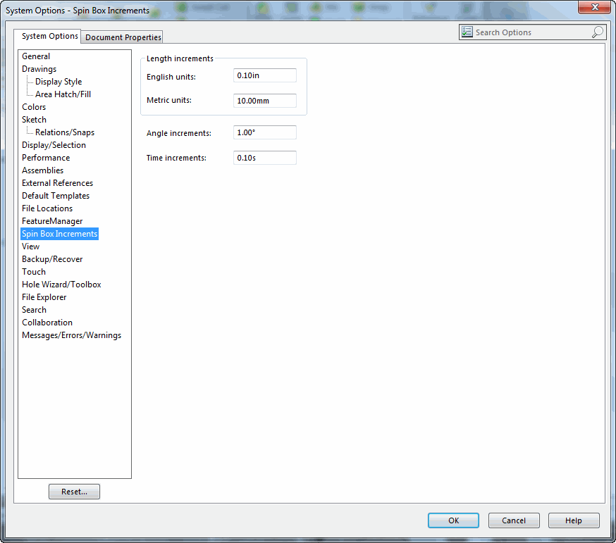

System Options > Spin Box Increments
Setting
Get/Set Methods
Return Value
or
<Value>
Comment
Length increments - English units
ISldWorks::GetUserPreferenceDoubleValue(swUserPreferenceDoubleValue_e.swSpinBoxEnglishLengthIncrement)
ISldWorks::SetUserPreferenceDoubleValue(swUserPreferenceDoubleValue_e.swSpinBoxEnglishLengthIncrement, <Value>)
Double value in inches
Specifies number of inches added or subtracted when spin box arrow is clicked to change a linear dimension value; see Units to learn how to set length units using the SOLIDWORKS API
Length increments - Metric units
ISldWorks::GetUserPreferenceDoubleValue(swUserPreferenceDoubleValue_e.swSpinBoxMetricLengthIncrement)
ISldWorks::SetUserPreferenceDoubleValue(swUserPreferenceDoubleValue_e.swSpinBoxMetricLengthIncrement, <Value>)
Double value in metric units
Specifies number of units added or subtracted when a spin box arrow is clicked to change a linear dimension value; see Units to learn how to set length units using the SOLIDWORKS API
Angle increments
ISldWorks::GetUserPreferenceDoubleValue(swUserPreferenceDoubleValue_e.swSpinBoxAngleIncrement)
ISldWorks::SetUserPreferenceDoubleValue(swUserPreferenceDoubleValue_e.swSpinBoxAngleIncrement, <Value>)
Double value in angular units
Specifies number of angular units added or subtracted when a spin box arrow is clicked to change an angular dimension value; see Units to learn how to set angular units using the SOLIDWORKS API
Time increments
ISldWorks::GetUserPreferenceDoubleValue(swUserPreferenceDoubleValue_e.swSpinBoxTimeIncrement)
ISldWorks::SetUserPreferenceDoubleValue(swUserPreferenceDoubleValue_e.swSpinBoxTimeIncrement, <Value>)
Double value in time units
Specifies number of units added or subtracted when a spin box arrow is clicked to change a time value; see Units to learn how to set time units using the SOLIDWORKS API
