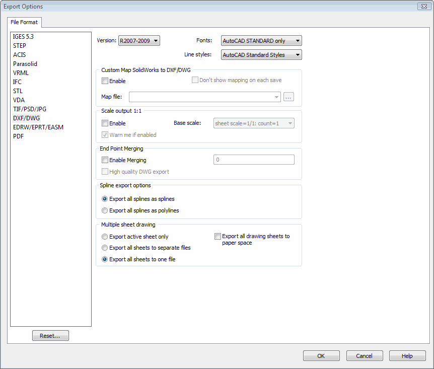

This topic contains four tables. The information in the table:
  • appearing immediately after the screen capture of the Export Options - File Format - DXF/DWG dialog corresponds to the settings on that dialog.

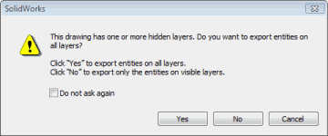

  • titled Hidden Layers Dialog Enumerators contains enumerators corresponding to options on the hidden layers warning dialog that pops up during export to DXF/DWG of drawings that have one or more hidden layers.

Version
ISldWorks::GetUserPreferenceIntegerValue(swUserPreferenceIntegerValue_e.swDxfVersion) ISldWorks::SetUserPreferenceIntegerValue(swUserPreferenceIntegerValue_e.swDxfVersion, swDxfFormat.e.<Value>)
See swDxfFormat_e for valid options
Fonts
ISldWorks::GetUserPreferenceIntegerValue(swUserPreferenceIntegerValue_e.swDxfOutputFonts) ISldWorks::SetUserPreferenceIntegerValue(swUserPreferenceIntegerValue_e.swDxfOutputFonts, swDxfFormat.e.<Value>)
  • 0 = AutoCAD STANDARD only
  • 1 = TrueType
Line styles
ISldWorks::GetUserPreferenceIntegerValue(swUserPreferenceIntegerValue_e.swDxfOutputLineStyles) ISldWorks::SetUserPreferenceIntegerValue(swUserPreferenceIntegerValue_e.swDxfOutputLineStyles, swDxfFormat.e.<Value>)
  • 0 = AutoCAD Standard Styles
  • 1 = SOLIDWORKS Custom Styles
Custom Map SOLIDWORKS to DXF/DWG - Enable
ISldWorks::GetUserPreferenceToggle(swUserPreferenceToggle_e.swDxfMapping)
ISldWorks::SetUserPreferenceToggle(swUserPreferenceToggle_e.swDxfMapping, <OnFlag>)
Boolean value
Specifies whether to implement mapping
Custom Map SOLIDWORKS to DXF/DWG - Don't show mapping on each save
ISldWorks::GetUserPreferenceToggle(swUserPreferenceToggle_e.swDXFDontShowMap)
ISldWorks::SetUserPreferenceToggle(swUserPreferenceToggle_e.swDXFDontShowMap, <OnFlag>)
Boolean value
Specifies whether dialog appears when saving drawing when swDxfMapping set to True
Custom Map SOLIDWORKS to DXF/DWG - Map file
ISldWorks::GetUserPreferenceStringListValue(swUserPreferenceStringListValue_e.swDxfMappingFiles)
ISldWorks::SetUserPreferenceStringListValue(swUserPreferenceStringListValue_e.swDxfMappingFiles, <Value>)
IMPORTANT: In addition to specifying the custom map file, you must specify a custom map file index to indicate which custom map file to use in the custom map file list.
The following code snippet shows how to specify the custom map file index when adding the first custom map file to the custom map file list:
swApp.SetUserPreferenceStringListValue swUserPreferenceStringListValue_e.swDxfMappingFiles, mapFilePath
index = swApp.GetUserPreferenceIntegerValue (swUserPreferenceIntegerValue_e.swDxfMappingFileIndex)
If (index = -1) Then
swApp.SetUserPreferenceIntegerValue swUserPreferenceIntegerValue_e.swDxfMappingFileIndex, 0
End If
index = swApp.GetUserPreferenceIntegerValue(swUserPreferenceIntegerValue_e.swDxfMappingFileIndex)
result= swModel.SaveAs4(outputPath, swSaveAsVersion_e.swSaveAsCurrentVersion, swSaveAsOptions_e.swSaveAsOptions_Silent, errors, warnings)
String value
Sets up DXF/DWG mapping file; setting is persistent across SOLIDWORKS sessions; you can also interactively get or set the custom map file setting by clicking File, Save As, .dxf or .dwg as Save as type, and Options; separate each string in the list by a line feed  (e.g., the vbLf constant in Visual Basic)
Scale output 1:1 - Enable
ISldWorks::GetUserPreferenceIntegerValue(swUserPreferenceIntegerValue_e.swDxfOutputNoScale) ISldWorks::SetUserPreferenceIntegerValue(swUserPreferenceIntegerValue_e.swDxfOutputNoScale, <Value>)
  • 0 = no scale
  • 1 = 1:1 scale
Scale output 1:1 - Base scale
See Comment
See Comment
Not currently available in SOLIDWORKS API
Scale output 1:1 - Warn me if enabled
See Comment
See Comment
End Point Merging - Enable Merging
ISldWorks::GetUserPreferenceToggle(swUserPreferenceToggle_e.swDxfEndPointMerge)
ISldWorks::SetUserPreferenceToggle(swUserPreferenceToggle_e.swDxfEndPointMerge, <OnFlag>)
Boolean value
Specifies whether to merge the end points of entities when exporting a part  to a DXF/DWG file; this option helps to avoid gaps between model edges, but it increases the export time; it is off by default
End Point Merging - <n>
ISldWorks::GetUserPreferenceDoubleValue(swUserPreferenceDoubleValue_e.swDxfMergingDistance)
ISldWorks::SetUserPreferenceDoubleValue(swUserPreferenceDoubleValue_e.swDxfMergingDistance, <Value>)
Double value
Specifies the tolerance within which gaps between line endpoints are eliminated
End Point Merging - High quality DWG export
ISldWorks::GetUserPreferenceToggle(swUserPreferenceToggle_e.swDXFHighQualityExport)
ISldWorks::SetUserPreferenceToggle(swUserPreferenceToggle_e.swDXFHighQualityExport, <OnFlag>)
Boolean value
Only for End Point Merging - Enable Merging set to True; specifies whether to export at a higher level of quality (with a possible increase in time to export)
Spline export options - Export all splines as splines
ISldWorks::GetUserPreferenceToggle(swUserPreferenceToggle_e.swDxfExportSplinesAsSplines)
ISldWorks::SetUserPreferenceToggle(swUserPreferenceToggle_e.swDxfExportSplinesAsSplines, <OnFlag>)
True
Specifies to export all splines as splines
Spline export options - Export all splines as polylines
False
Specifies to export all splines as polylines
Multiple sheet drawing - Export active sheet only
ISldWorks::GetUserPreferenceIntegerValue(swUserPreferenceIntegerValue_e.swDxfMultiSheetOption) ISldWorks::SetUserPreferenceIntegerValue(swUserPreferenceIntegerValue_e.swDxfMultiSheetOption, swDxfMultiSheet_e.swDxfActiveSheetOnly)
See swDxfMultiSheet_e for all valid options
Multiple sheet drawing - Export all sheets to separate files
ISldWorks::GetUserPreferenceIntegerValue(swUserPreferenceIntegerValue_e.swDxfMultiSheetOption) ISldWorks::SetUserPreferenceIntegerValue(swUserPreferenceIntegerValue_e.swDxfMultiSheetOption, swDxfMultiSheet_e.swDxfSeparateSheets)
Multiple sheet drawing - Export all sheets to one file
ISldWorks::GetUserPreferenceIntegerValue(swUserPreferenceIntegerValue_e.swDxfMultiSheetOption) ISldWorks::SetUserPreferenceIntegerValue(swUserPreferenceIntegerValue_e.swDxfMultiSheetOption, swDxfMultiSheet_e.swDxfMultiSheet)
Multiple sheet drawing - Export all drawing sheets to paper space
ISldWorks::GetUserPreferenceToggle(swUserPreferenceToggle_e.swDxfExportAllSheetsToPaperSpace)
ISldWorks::SetUserPreferenceToggle(swUserPreferenceToggle_e.swDxfExportAllSheetsToPaperSpace, <OnFlag>)
Boolean
Specifies to export all sheets to paper space

Do you want to export entities on all layers? <Yes/No>
ISldWorks::GetUserPreferenceToggle(swUserPreferenceToggle_e.swDXFExportHiddenLayersOn)
ISldWorks::SetUserPreferenceToggle(swUserPreferenceToggle_e.swDXFExportHiddenLayersOn, <OnFlag>)
Boolean value
Specifies whether to export layers that are hidden in the drawing
Do not ask again
ISldWorks::GetUserPreferenceToggle(swUserPreferenceToggle_e.swDXFExportHiddenLayersWarnIsOn)
ISldWorks::SetUserPreferenceToggle(swUserPreferenceToggle_e.swDXFExportHiddenLayersWarnIsOn, <OnFlag>)
Boolean value
Specifies whether to dismiss the hidden layers warning dialog on export; restore the dismissed dialog in System Options > Advanced
