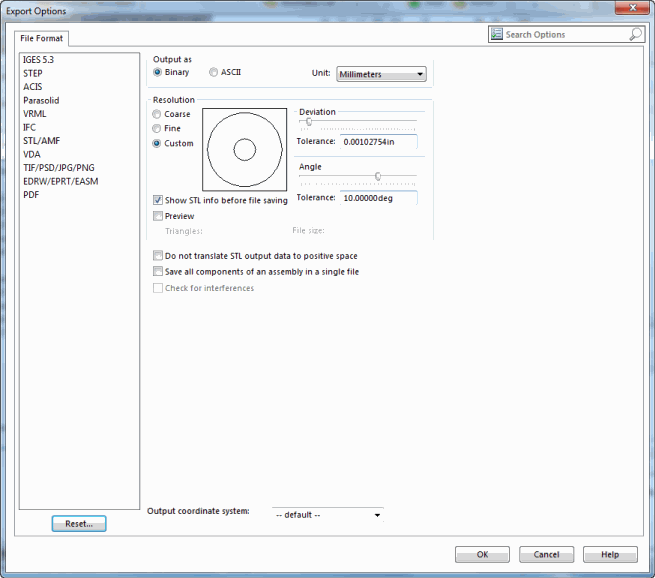

File > Save As > Save as type > STL > Options > STL
Setting
Get/Set Methods
Return Value
or
<Value>
or
<OnFlag>
Comment
Output as - Binary
ISldWorks::GetUserPreferenceToggle(swUserPreferenceToggle_e, swSTLBinaryFormat)
ISldWorks::SetUserPreferenceToggle(swUserPreferenceToggle_e, swSTLBinaryFormat, <OnFlag>)
True
Output as - ASCII
False
Output - Unit
ISldWorks::GetUserPreferenceIntegerValue(swUserPreferenceIntegerValue_e.swExportStlUnits)
ISldWorks::SetUserPreferenceIntegerValue(swUserPreferenceIntegerValue_e.swExportStlUnits, swLengthUnit_e.<Value>)
Valid options as defined in swLengthUnit_e:
  • 0 = swMM (millimeters)
  • 1 = swCM (centimeters)
  • 2 = swMETER
  • 3 = swINCHES
  • 4 = swFEET
Resolution -
  • Coarse
  • Fine
  • Custom
ISldWorks::GetUserPreferenceIntegerValue(swUserPreferenceIntegerValue_e.swSTLQuality)
ISldWorks::SetUserPreferenceIntegerValue(swUserPreferenceIntegerValue_e.swSTLQuality, swSTLQuality_e.<Value>)
See swSTLQuality_e for valid options
Specifies the resolution of the output for STL files
Resolution - Deviation - Tolerance
ISldWorks::GetUserPreferenceDoubleValue(swUserPreferenceDoubleValue_e.swSTLDeviation)
ISldWorks::SetUserPreferenceDoubleValue(swUserPreferenceDoubleValue_e.swSTLDeviation, <Value>)
Double value
Specifies deviation tolerance, which controls whole-part tessellation; lower numbers generate files with greater whole-part accuracy
Resolution - Angle - Tolerance
ISldWorks::GetUserPreferenceDoubleValue(swUserPreferenceDoubleValue_e.swSTLAngleTolerance)
ISldWorks::SetUserPreferenceDoubleValue(swUserPreferenceDoubleValue_e.swSTLAngleTolerance, <Value>)
Double value
Specifies angle tolerance, which controls smaller detail tessellation; lower numbers generate files with greater small-detail accuracy, but those files take longer to generate
Resolution - Show STL info before file saving
ISldWorks::GetUserPreferenceToggle(swUserPreferenceToggle_e, swSTLShowInfoOnSave)
ISldWorks::SetUserPreferenceToggle(swUserPreferenceToggle_e, swSTLShowInfoOnSave, <OnFlag>)
Boolean value
Specifies whether to show STL information before saving the file
Resolution - Preview
ISldWorks::GetUserPreferenceToggle(swUserPreferenceToggle_e, swSTLPreview)
ISldWorks::SetUserPreferenceToggle(swUserPreferenceToggle_e, swSTLPreview, <OnFlag>)
Boolean value
Specifies whether faceted model preview is displayed in the graphics area
Do not translate STL output data to positive space
ISldWorks::GetUserPreferenceToggle(swUserPreferenceToggle_e, swSTLDontTranslateToPositive)
ISldWorks::SetUserPreferenceToggle(swUserPreferenceToggle_e, swSTLDontTranslateToPositive, <OnFlag>)
Boolean value
Specifies whether exported parts maintain original position in global space, relative to origin
Save all components of an assembly in a single file
ISldWorks::GetUserPreferenceToggle(swUserPreferenceToggle_e, swSTLComponentsIntoOneFile)
ISldWorks::SetUserPreferenceToggle(swUserPreferenceToggle_e, swSTLComponentsIntoOneFile, <OnFlag>)
Boolean value
Specifies whether to save the assembly and its components in single .stl file
Check for interferences
ISldWorks::GetUserPreferenceToggle(swUserPreferenceToggle_e, swSTLCheckForInterference)
ISldWorks::SetUserPreferenceToggle(swUserPreferenceToggle_e, swSTLCheckForInterference, <OnFlag>)
Boolean value
Specifies whether to check for interference prior to saving assembly document; swUserPreferenceToggle_e.swSTLComponentsIntoOneFile must be set to true
Output coordinate system
IModelDocExtension::GetUserPreferenceString(swUserPreferenceString_e.swFileSaveAsCoordinateSystem, swUserPreferenceOption_e.swDetailingNoOptionSpecified)
IModelDocExtension::SetUserPreferenceString(swUserPreferenceString_e.swFileSaveAsCoordinateSystem, swUserPreferenceOption_e.swDetailingNoOptionSpecified, <Value>)
String value
Contains the name of the transform coordinate system; an empty string signifies that the  default coordinate system that does not require a transform; coordinate settings are not saved with the document; they must be selected at export time
