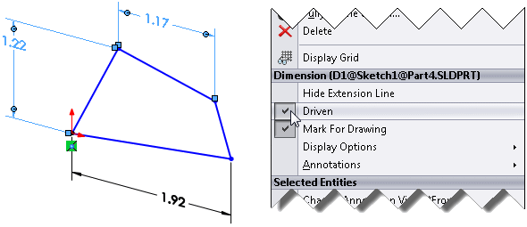

Setting Multiple Dimensions to Driven
When you select multiple dimensions, the Driven option on the shortcut menu lets you set the dimensions to driven.
In previous versions of SOLIDWORKS, you could only set multiple dimensions to driven using the Other tab in the Dimension PropertyManager.
