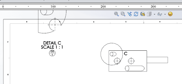

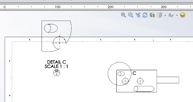

Zoom to Sheet zooms to maximize the drawing sheet within the current viewport. If interface elements such as the Heads-Up View toolbar or the Task Pane are present, it zooms to fit the sheet to the window with no portion appearing under those interface elements.
For example, if you have a drawing view with geometry within the sheet, but a bounding box that extends beyond the sheet, Zoom to Sheet focuses on the sheet only and zooms the sheet to fit the window. In contrast, Zoom to Fit zooms to include the bounding box.
