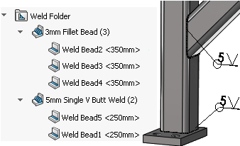

    In this image, there are:
    • Four 3mm Fillet Beads
    • One 5mm Single V Butt Weld
  3. Select the Weld Bead to change, then drag it to a different Weld subfolder and drop it when the pointer changes to pointer_add_to_folder.gif.

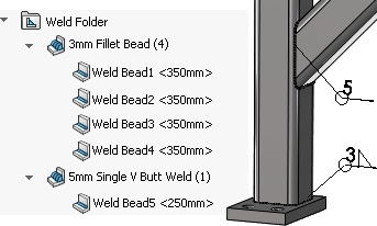

  4. Click OK.
    The weld bead moves to the new Weld subfolder and its type, size, and symbol are updated. The Weld subfolder increments by the number of weld beads you added to the folder.
