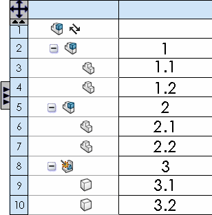

Dissolving a Subassembly or Weldment in BOMs
You can dissolve components of subassemblies or weldments in a bill of materials (BOM).
To dissolve one or more selected subassemblies or weldment parts in a BOM:
  1. Click the left side of the BOM table to display the assembly structure column in the BOM if it is hidden.
  2. Right-click one or more selected cells in the assembly structure column that contains a set of subassemblies or weldment parts .
  3. Select Dissolve.
    Modified items are marked .
    To undo one or more dissolves, right-click a cell in the assembly structure of the BOM indicating dissolved items and select Restore Restructured Components.
