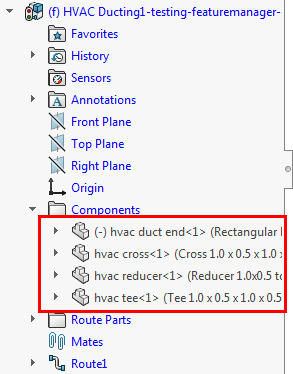

When Routing Components are Part of the Top Level Assembly
When routing components are added when not editing the route subassembly, the parts are added as components of the top level assembly. Top level assembly components cannot be moved while editing the route. Dimensioning the route 3D sketch will not affect the placement of the route components but can be used to define specific route paths.
To use a top level assembly component in a route, right click on the CPoint of the component and select Add to Route.
Route components fully defined using mates before routing: Route segments added to route components after routing:
