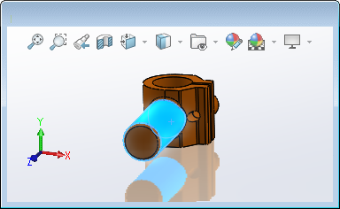

The Mated Entities PropertyManager opens. Additionally, the Missing Entities pop-up toolbar appears, and a window shows the original component with the missing mate entity highlighted.
