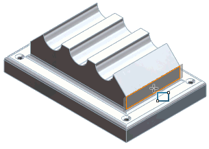

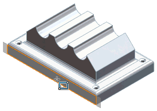

RapidSketch allows you to select planar faces or planes, and with any sketch tool active, start to sketch. As you move to each planar face, a plane is created and a sketch is opened. You can change sketch tools midstream.
- With a model open, select the Sketch tab and click RapidSketch
or RapidSketch
(Sketch toolbar).
- Select a sketch tool.
- Place the pointer on a planar face or plane and start to sketch.
