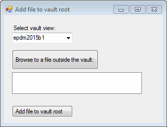

This example shows how to add a file outside the vault to the vault root.

// Postconditions:
// 1. Displays the Add file to vault root dialog box.
//    a. Select a vault view.
//    b. Click Browse to a file outside the vault
//       1. Locate a file outside the vault that exists in
//          a subfolder in the vault.
//       2. Click Open.
//    c. Click Add file to vault root to add the selected file to the
//       root folder of the vault.
//    d. Displays a message box warning you that the selected file is not
//       unique in the vault, but that the file will be added to the vault root.
//    e. Click OK.
// 2. Close the Add file to vault root dialog box.
// 3. Examine the vault root.

        private void InitializeComponent()
            this.VaultsLabel = new System.Windows.Forms.Label();
            this.VaultsComboBox = new System.Windows.Forms.ComboBox();
            this.BrowseButton = new System.Windows.Forms.Button();
            this.ListBox = new System.Windows.Forms.ListBox();
            this.AddFiles = new System.Windows.Forms.Button();
            this.OpenFileDialog = new System.Windows.Forms.OpenFileDialog();
            this.SuspendLayout();
            // VaultsLabel
            this.VaultsLabel.AutoSize = true;
            this.VaultsLabel.Location = new System.Drawing.Point(13, 26);
            this.VaultsLabel.Name = "VaultsLabel";
            this.VaultsLabel.Size = new System.Drawing.Size(94, 13);
            this.VaultsLabel.TabIndex = 0;
            this.VaultsLabel.Text = " Select vault view:";
            // VaultsComboBox
            this.VaultsComboBox.FormattingEnabled = true;
            this.VaultsComboBox.Location = new System.Drawing.Point(16, 42);
            this.VaultsComboBox.Name = "VaultsComboBox";
            this.VaultsComboBox.Size = new System.Drawing.Size(121, 21);
            this.VaultsComboBox.TabIndex = 1;
            // BrowseButton
            this.BrowseButton.ImageAlign = System.Drawing.ContentAlignment.MiddleLeft;
            this.BrowseButton.Location = new System.Drawing.Point(16, 69);
            this.BrowseButton.Name = "BrowseButton";
            this.BrowseButton.Size = new System.Drawing.Size(259, 39);
            this.BrowseButton.TabIndex = 3;
            this.BrowseButton.Text = "Browse to a file outside the vault:";
            this.BrowseButton.TextAlign = System.Drawing.ContentAlignment.MiddleLeft;
            this.BrowseButton.UseVisualStyleBackColor = true;
            this.BrowseButton.Click += new System.EventHandler(this.BrowseButton_Click);
            // ListBox
            this.ListBox.FormattingEnabled = true;
            this.ListBox.HorizontalScrollbar = true;
            this.ListBox.Location = new System.Drawing.Point(16, 114);
            this.ListBox.Name = "ListBox";
            this.ListBox.SelectionMode = System.Windows.Forms.SelectionMode.MultiExtended;
            this.ListBox.Size = new System.Drawing.Size(259, 43);
            this.ListBox.TabIndex = 4;
            // AddFiles
            this.AddFiles.Location = new System.Drawing.Point(16, 163);
            this.AddFiles.Name = "AddFiles";
            this.AddFiles.Size = new System.Drawing.Size(121, 23);
            this.AddFiles.TabIndex = 5;
            this.AddFiles.Text = "Add file to vault root";
            this.AddFiles.TextAlign = System.Drawing.ContentAlignment.MiddleLeft;
            this.AddFiles.UseVisualStyleBackColor = true;
            this.AddFiles.Click += new System.EventHandler(this.AddFiles_Click);
            // OpenFileDialog
            this.OpenFileDialog.Multiselect = true;
            this.OpenFileDialog.Title = "Open";
            // Form1
            this.AutoScaleDimensions = new System.Drawing.SizeF(6F, 13F);
            this.AutoScaleMode = System.Windows.Forms.AutoScaleMode.Font;
            this.ClientSize = new System.Drawing.Size(317, 215);
            this.Controls.Add(this.AddFiles);
            this.Controls.Add(this.ListBox);
            this.Controls.Add(this.BrowseButton);
            this.Controls.Add(this.VaultsComboBox);
            this.Controls.Add(this.VaultsLabel);
            this.Name = "Form1";
            this.Text = "Add file to vault root";
            this.Load += new System.EventHandler(this.Form1_Load);
            this.ResumeLayout(false);
            this.PerformLayout();
        #endregion
        internal System.Windows.Forms.Label VaultsLabel;
        internal System.Windows.Forms.ComboBox VaultsComboBox;
        internal System.Windows.Forms.Button BrowseButton;
        internal System.Windows.Forms.ListBox ListBox;
        internal System.Windows.Forms.Button AddFiles;
        internal System.Windows.Forms.OpenFileDialog OpenFileDialog;
