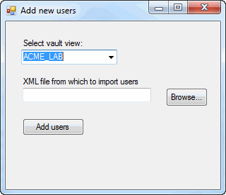

This example shows how to add users to a vault by deserializing an XML file containing user data.

'     f. Create a form similar to the form shown above and change:
'        1. Top label to VaultsLabel.
'        2. Combo box to VaultsComboBox.
'        3. Second label to XmlLabel.
'        4. Text box to XmlTextBox.
'        5. Browse button to BrowseButton.
'        6. Add users button to AddUsersButton.

' Postconditions:
'  1. Displays a dialog.
'  2. Select a vault.
'  3. Click Browse, locate and click User.xml, and click Open.
'  4. Click Add users.
'     A message box is displayed showing the names and IDs of the new users added
'     to the vault.
'  5. Click OK to close the message box.
'  6. Close the dialog.

        Me.VaultsLabel.AutoSize = True
        Me.VaultsLabel.Location = New System.Drawing.Point(22, 24)
        Me.VaultsLabel.Margin = New System.Windows.Forms.Padding(2, 0, 2, 0)
        Me.VaultsLabel.Name = "VaultsLabel"
        Me.VaultsLabel.Size = New System.Drawing.Size(91, 13)
        Me.VaultsLabel.TabIndex = 13
        Me.VaultsLabel.Text = "Select vault view:"
        'AddUsers
        Me.AutoScaleDimensions = New System.Drawing.SizeF(6.0!, 13.0!)
        Me.AutoScaleMode = System.Windows.Forms.AutoScaleMode.Font
        Me.ClientSize = New System.Drawing.Size(304, 237)
        Me.Controls.Add(Me.VaultsComboBox)
        Me.Controls.Add(Me.VaultsLabel)
        Me.Controls.Add(Me.AddUsersButton)
        Me.Controls.Add(Me.XmlLabel)
        Me.Controls.Add(Me.XmlTextBox)
        Me.Controls.Add(Me.BrowseButton)
        Me.Margin = New System.Windows.Forms.Padding(2)
        Me.Name = "AddUsers"
        Me.Text = "Add new users"
        Me.ResumeLayout(False)
        Me.PerformLayout()

    Friend WithEvents BrowseButton As System.Windows.Forms.Button
    Friend WithEvents XmlTextBox As System.Windows.Forms.TextBox
    Friend WithEvents XmlLabel As System.Windows.Forms.Label
    Friend WithEvents XmlOpenFileDialog As System.Windows.Forms.OpenFileDialog
    Friend WithEvents AddUsersButton As System.Windows.Forms.Button
    Friend WithEvents VaultsComboBox As System.Windows.Forms.ComboBox
    Friend WithEvents VaultsLabel As System.Windows.Forms.Label
