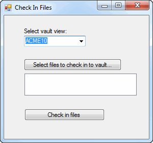

// Postconditions:
// 1. Displays the Check In Files dialog box.
//    a. Select a vault view.
//    b. Click Select files to check out from vault.
//    c. In the Select File dialog:
//       1. Click the checked-out vault file.
//       2. Click Open.
//    d. Click Check in files.
//    e. Displays the Check in dialog box with the Reload or Close Files
//       after Check In
dropdown in the toolbar.
//    f. Click the Check in button.
//    g. Click OK in the message box.
// 2. Close the Check In Files dialog box.
// 3. Observe that the selected file is checked in to the selected vault.

            this.ResumeLayout(false);
            this.PerformLayout();
        internal System.Windows.Forms.Label VaultsLabel;
        internal System.Windows.Forms.ComboBox VaultsComboBox;
        internal System.Windows.Forms.Button SelectFiles;
        internal System.Windows.Forms.ListBox File1List;
        internal System.Windows.Forms.Button BatchUnlock;
        internal System.Windows.Forms.OpenFileDialog OpenFileDialog1;
