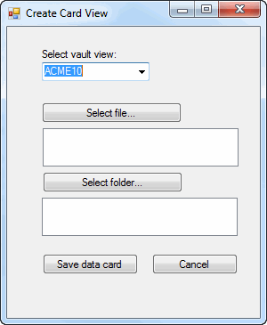

' 1. Displays the Create Card View dialog box.
' 2. Select a vault view.
' 3. Click either:

'Form1.vb

Me.Folder1List.Location = New System.Drawing.Point(39, 192)
Me.Folder1List.Name = "Folder1List"
Me.Folder1List.Size = New System.Drawing.Size(220, 43)
Me.Folder1List.TabIndex = 8
'Cancel
Me.Cancel.Location = New System.Drawing.Point(163, 255)
Me.Cancel.Name = "Cancel"
Me.Cancel.Size = New System.Drawing.Size(96, 23)
Me.Cancel.TabIndex = 9
Me.Cancel.Text = "Cancel"
Me.Cancel.UseVisualStyleBackColor = True
'Form1
Me.AutoScaleDimensions = New System.Drawing.SizeF(6.0!, 13.0!)
Me.AutoScaleMode = System.Windows.Forms.AutoScaleMode.Font
Me.ClientSize = New System.Drawing.Size(284, 327)
Me.Controls.Add(Me.Cancel)
Me.Controls.Add(Me.Folder1List)
Me.Controls.Add(Me.SelectFolder)
Me.Controls.Add(Me.SaveCard)
Me.Controls.Add(Me.File1List)
Me.Controls.Add(Me.SelectFile)
Me.Controls.Add(Me.VaultsComboBox)
Me.Controls.Add(Me.VaultsLabel)
Me.Name = "Form1"
Me.Text = "Create Card View"
Me.ResumeLayout(False)
Me.PerformLayout()
End Sub
Friend WithEvents VaultsLabel As System.Windows.Forms.Label
Friend WithEvents VaultsComboBox As System.Windows.Forms.ComboBox
Friend WithEvents SelectFile As System.Windows.Forms.Button
Friend WithEvents File1List As System.Windows.Forms.ListBox
Friend WithEvents SaveCard As System.Windows.Forms.Button
Friend WithEvents OpenFileDialog1 As System.Windows.Forms.OpenFileDialog
Friend WithEvents SelectFolder As System.Windows.Forms.Button
Friend WithEvents Folder1List As System.Windows.Forms.ListBox
Friend WithEvents Cancel As System.Windows.Forms.Button
End Class
