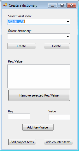

' Postconditions:
' 1. Displays a dialog.
' 2. Select a vault.
' 3. Select the Projects dictionary.
'    a. Click Create.
'    b. Click Add project items.
'       The Key/Value list is populated with the
'       Projects dictionary's keys and values.
'    c. Type a unique value in Key and any value in Value.
'    d. Click Add Key/Value.
'       The key and value are added to the Key/Value list.
'    e. Select a key and value in the Key/Value list and
'       click Remove selected Key/Value.
'       The selected key and value are deleted from the
'       dictionary.
'    f. Type an existing key in Key and any value in Value.
'    g. Click Add Key/Value.
'       A message box is displayed informing you that the
'       duplicate keys are prohibited. Neither the key
'       nor value was added to the dictionary.
'    h. Click OK to close the message box.
' 4. Select the Counters dictionary.
'    a. Click Create.
'    b. Click Add counter items.
'       The Key/Value list is populated with the Counters
'       dictionary's keys and values.
' 5. Experiment with creating your own dictionary and adding
'    and removing keys and values to and from that dictionary.
' 6. Close the dialog.

      Handles AddCounterItemsButton.Click
        Try
            If Not vault.IsLoggedIn Then
                'Log into selected vault as the current user
                vault.LoginAuto(VaultsComboBox.Text, _
                   Me.Handle.ToInt32())
            End If
            Dim CounterDictionary As IEdmDictionary5
            CounterDictionary = vault.GetDictionary _
              ("Counters"True'Create it, if it doesn't exist
            'Add the new dictionary name to the list box,
            'if it doesn't exist
            If Not DictionaryComboBox.Items.Contains( _
                "Counters"Then
                DictionaryComboBox.Items.Add("Counters")
            End If
            Dim SuccessSet As Boolean = False
            SuccessSet = CounterDictionary.StringTestAndSetAt _
              ("Electric""5")
              ("Hybrid""10")
              ("Gasoline""15")
              ("Diesel""20")
            If DictionaryComboBox.Text = "Counters" Then
                DisplayDictionaryItems("Counters", _
                  CounterDictionary, KeyValueListBox)
            Else
            End If
        Catch ex As Runtime.InteropServices.COMException
            MessageBox.Show("HRESULT = 0x" + _
            ex.ErrorCode.ToString("X") + vbCrLf + _
            ex.Message)
        Catch ex As Exception
            MessageBox.Show(ex.Message)
        End Try
    End Sub
    Private Sub DisplayDictionaryItems( _
      ByVal DictionaryName As String, _
      ByVal Dictionary As IEdmDictionary5, _
      ByVal ListObject As Object)
        Try
            ListObject.Items.Clear()
            If Dictionary Is Nothing Then
                ListObject.Items.Add(DictionaryComboBox.Text + _
                  " dictionary doesn't exist.")
            Else
                'Traverse and display the Key/Value pairs
                'in the dictionary
                Dim Key As String = ""
                Dim Value As String = ""
                Dim Pos As IEdmPos5
                Pos = Dictionary.StringGetFirstPosition()
                While Not Pos.IsNull
                    Dictionary.StringGetNextAssoc(Pos, Key, Value)
                    ListObject.Items.Add(Key + vbTab + Value)
                End While
            End If
            ex.Message)
        End Try
    End Sub

   Private Sub InitializeComponent()
        Me.VaultsComboBox = New System.Windows.Forms.ComboBox()
        Me.VaultsLabel = New System.Windows.Forms.Label()
        Me.AddProjectItemsButton = New System.Windows.Forms.Button()
        Me.DictionaryComboBox = New System.Windows.Forms.ComboBox()
        Me.DictionaryLabel = New System.Windows.Forms.Label()
        Me.KeyValueListBox = New System.Windows.Forms.ListBox()
        Me.KeyValueLabel = New System.Windows.Forms.Label()
        Me.CreateButton = New System.Windows.Forms.Button()
        Me.DeleteButton = New System.Windows.Forms.Button()
        Me.KeyTextBox = New System.Windows.Forms.TextBox()
        Me.ValueTextBox = New System.Windows.Forms.TextBox()
        Me.KeyLabel = New System.Windows.Forms.Label()
        Me.ValueLabel = New System.Windows.Forms.Label()
        Me.AddKeyValueButton = New System.Windows.Forms.Button()
        Me.RemoveButton = New System.Windows.Forms.Button()
        Me.AddCounterItemsButton = New System.Windows.Forms.Button()
        Me.SuspendLayout()
        'VaultsComboBox
        Me.VaultsComboBox.FormattingEnabled = True
        Me.VaultsComboBox.Location = New System.Drawing.Point(17, 35)
        Me.VaultsComboBox.Margin = New System.Windows.Forms.Padding(2)
        Me.VaultsComboBox.Name = "VaultsComboBox"
        Me.VaultsComboBox.Size = New System.Drawing.Size(218, 21)
        Me.VaultsComboBox.TabIndex = 14
        'VaultsLabel
        Me.VaultsLabel.AutoSize = True
        Me.VaultsLabel.Location = New System.Drawing.Point(17, 19)
        Me.VaultsLabel.Margin = New System.Windows.Forms.Padding(2, 0, 2, 0)
        Me.VaultsLabel.Name = "VaultsLabel"
        Me.VaultsLabel.Size = New System.Drawing.Size(91, 13)
        Me.VaultsLabel.TabIndex = 15
        Me.VaultsLabel.Text = "Select vault view:"
        'AddProjectItemsButton
        Me.AddProjectItemsButton.Location = New System.Drawing.Point(20, 451)
        Me.AddProjectItemsButton.Margin = New System.Windows.Forms.Padding(2)
        Me.AddProjectItemsButton.Name = "AddProjectItemsButton"
        Me.AddProjectItemsButton.Size = New System.Drawing.Size(98, 24)
        Me.AddProjectItemsButton.TabIndex = 16
        Me.AddProjectItemsButton.Text = "Add project items"
        Me.AddProjectItemsButton.UseVisualStyleBackColor = True
        'DictionaryComboBox
        Me.DictionaryComboBox.FormattingEnabled = True
        Me.DictionaryComboBox.Items.AddRange(New Object() {"Projects""Counters"})
        Me.DictionaryComboBox.Location = New System.Drawing.Point(17, 86)
        Me.DictionaryComboBox.Margin = New System.Windows.Forms.Padding(2)
        Me.DictionaryComboBox.Name = "DictionaryComboBox"
        Me.DictionaryComboBox.Size = New System.Drawing.Size(218, 21)
        Me.DictionaryComboBox.TabIndex = 17
        'DictionaryLabel
        Me.DictionaryLabel.AutoSize = True
        Me.DictionaryLabel.Location = New System.Drawing.Point(17, 70)
        Me.DictionaryLabel.Margin = New System.Windows.Forms.Padding(2, 0, 2, 0)
        Me.DictionaryLabel.Name = "DictionaryLabel"
        Me.DictionaryLabel.Size = New System.Drawing.Size(88, 13)
        Me.DictionaryLabel.TabIndex = 18
        Me.DictionaryLabel.Text = "Select dictionary:"
        'KeyValueListBox
        Me.KeyValueListBox.FormattingEnabled = True
        Me.KeyValueListBox.Location = New System.Drawing.Point(17, 194)
        Me.KeyValueListBox.Margin = New System.Windows.Forms.Padding(2)
        Me.KeyValueListBox.Name = "KeyValueListBox"
        Me.KeyValueListBox.Size = New System.Drawing.Size(218, 82)
        Me.KeyValueListBox.TabIndex = 19
        'KeyValueLabel
        Me.KeyValueLabel.AutoSize = True
        Me.KeyValueLabel.Location = New System.Drawing.Point(17, 176)
        Me.KeyValueLabel.Margin = New System.Windows.Forms.Padding(2, 0, 2, 0)
        Me.KeyValueLabel.Name = "KeyValueLabel"
        Me.KeyValueLabel.Size = New System.Drawing.Size(57, 13)
        Me.KeyValueLabel.TabIndex = 20
        Me.KeyValueLabel.Text = "Key/Value"
        'CreateButton
        Me.CreateButton.Location = New System.Drawing.Point(17, 118)
        Me.CreateButton.Margin = New System.Windows.Forms.Padding(2)
        Me.CreateButton.Name = "CreateButton"
        Me.CreateButton.Size = New System.Drawing.Size(101, 24)
        Me.CreateButton.TabIndex = 21
        Me.CreateButton.Text = "Create"
        Me.CreateButton.UseVisualStyleBackColor = True
        'DeleteButton
        Me.DeleteButton.Location = New System.Drawing.Point(142, 118)
        Me.DeleteButton.Margin = New System.Windows.Forms.Padding(2)
        Me.DeleteButton.Name = "DeleteButton"
        Me.DeleteButton.Size = New System.Drawing.Size(93, 24)
        Me.DeleteButton.TabIndex = 22
        Me.DeleteButton.Text = "Delete"
        Me.DeleteButton.UseVisualStyleBackColor = True
        'KeyTextBox
        Me.KeyTextBox.Location = New System.Drawing.Point(20, 364)
        Me.KeyTextBox.Margin = New System.Windows.Forms.Padding(2)
        Me.KeyTextBox.Name = "KeyTextBox"
        Me.KeyTextBox.Size = New System.Drawing.Size(76, 20)
        Me.KeyTextBox.TabIndex = 23
        'ValueTextBox
        Me.ValueTextBox.Location = New System.Drawing.Point(159, 366)
        Me.ValueTextBox.Margin = New System.Windows.Forms.Padding(2)
        Me.ValueTextBox.Name = "ValueTextBox"
        Me.ValueTextBox.Size = New System.Drawing.Size(76, 20)
        Me.ValueTextBox.TabIndex = 24
        'KeyLabel
        Me.KeyLabel.AutoSize = True
        Me.KeyLabel.Location = New System.Drawing.Point(17, 349)
        Me.KeyLabel.Margin = New System.Windows.Forms.Padding(2, 0, 2, 0)
        Me.KeyLabel.Name = "KeyLabel"
        Me.KeyLabel.Size = New System.Drawing.Size(25, 13)
        Me.KeyLabel.TabIndex = 25
        Me.KeyLabel.Text = "Key"
        'ValueLabel
        Me.ValueLabel.AutoSize = True
        Me.ValueLabel.Location = New System.Drawing.Point(156, 349)
        Me.ValueLabel.Margin = New System.Windows.Forms.Padding(2, 0, 2, 0)
        Me.ValueLabel.Name = "ValueLabel"
        Me.ValueLabel.Size = New System.Drawing.Size(34, 13)
        Me.ValueLabel.TabIndex = 26
        Me.ValueLabel.Text = "Value"
        'AddKeyValueButton
        Me.AddKeyValueButton.Location = New System.Drawing.Point(68, 399)
        Me.AddKeyValueButton.Margin = New System.Windows.Forms.Padding(2)
        Me.AddKeyValueButton.Name = "AddKeyValueButton"
        Me.AddKeyValueButton.Size = New System.Drawing.Size(110, 25)
        Me.AddKeyValueButton.TabIndex = 27
        Me.AddKeyValueButton.Text = "Add Key/Value"
        Me.AddKeyValueButton.UseVisualStyleBackColor = True
        'RemoveButton
        Me.RemoveButton.Location = New System.Drawing.Point(20, 280)
        Me.RemoveButton.Margin = New System.Windows.Forms.Padding(2)
        Me.RemoveButton.Name = "RemoveButton"
        Me.RemoveButton.Size = New System.Drawing.Size(215, 41)
        Me.RemoveButton.TabIndex = 28
        Me.RemoveButton.Text = "Remove selected Key/Value"
        Me.RemoveButton.UseVisualStyleBackColor = True
        'AddCounterItemsButton
        Me.AddCounterItemsButton.Location = New System.Drawing.Point(142, 451)
        Me.AddCounterItemsButton.Margin = New System.Windows.Forms.Padding(2)
        Me.AddCounterItemsButton.Name = "AddCounterItemsButton"
        Me.AddCounterItemsButton.Size = New System.Drawing.Size(104, 24)
        Me.AddCounterItemsButton.TabIndex = 29
        Me.AddCounterItemsButton.Text = "Add counter items"
        Me.AddCounterItemsButton.UseVisualStyleBackColor = True
        'AddDictionary
        Me.AutoScaleDimensions = New System.Drawing.SizeF(6.0!, 13.0!)
        Me.AutoScaleMode = System.Windows.Forms.AutoScaleMode.Font
        Me.ClientSize = New System.Drawing.Size(257, 486)
        Me.Controls.Add(Me.AddCounterItemsButton)
        Me.Controls.Add(Me.RemoveButton)
        Me.Controls.Add(Me.AddKeyValueButton)
        Me.Controls.Add(Me.ValueLabel)
        Me.Controls.Add(Me.KeyLabel)
        Me.Controls.Add(Me.ValueTextBox)
        Me.Controls.Add(Me.KeyTextBox)
        Me.Controls.Add(Me.DeleteButton)
        Me.Controls.Add(Me.CreateButton)
        Me.Controls.Add(Me.KeyValueLabel)
        Me.Controls.Add(Me.KeyValueListBox)
        Me.Controls.Add(Me.DictionaryComboBox)
        Me.Controls.Add(Me.DictionaryLabel)
        Me.Controls.Add(Me.AddProjectItemsButton)
        Me.Controls.Add(Me.VaultsComboBox)
        Me.Controls.Add(Me.VaultsLabel)
        Me.Margin = New System.Windows.Forms.Padding(2)
        Me.Name = "AddDictionary"
        Me.Text = "Create a dictionary"
        Me.ResumeLayout(False)
        Me.PerformLayout()
    End Sub
