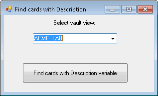

//  6. Create a form similar to the form shown above and change:
//     a. Label to VaultsLabel.
//     b. Combo box to VaultsComboBox
//     c. Button to FindCardsButton.
//  7. Replace the code in Form1.cs with this code.
//  8. Replace the code in Form1.Designer.cs with this code.

//  1. Displays a dialog.
//  2. Select a vault.
//  3. Click the Find cards with Description variable button.
//     The cards in your vault with a Description variable are
//     printed to the Immediate window.
//  4. Examine the Immediate window.
//  5. Close the dialog.

        private void InitializeComponent()
            this.VaultsLabel = new System.Windows.Forms.Label();
            this.VaultsComboBox = new System.Windows.Forms.ComboBox();
            this.FindCardsButton = new System.Windows.Forms.Button();
            this.SuspendLayout();
            // VaultsLabel
            this.VaultsLabel.AutoSize = true;
            this.VaultsLabel.Location = new System.Drawing.Point(86, 23);
            this.VaultsLabel.Name = "VaultsLabel";
            this.VaultsLabel.Size = new System.Drawing.Size(91, 13);
            this.VaultsLabel.TabIndex = 0;
            this.VaultsLabel.Text = "Select vault view:";
            // VaultsComboBox
            this.VaultsComboBox.FormattingEnabled = true;
            this.VaultsComboBox.Location = new System.Drawing.Point(70, 55);
            this.VaultsComboBox.Name = "VaultsComboBox";
            this.VaultsComboBox.Size = new System.Drawing.Size(121, 21);
            this.VaultsComboBox.TabIndex = 1;
            // FindCardsButton
            this.FindCardsButton.Location = new System.Drawing.Point(70, 95);
            this.FindCardsButton.Name = "FindCardsButton";
            this.FindCardsButton.Size = new System.Drawing.Size(121, 50);
            this.FindCardsButton.TabIndex = 2;
            this.FindCardsButton.Text = "Find cards with Description variable";
            this.FindCardsButton.UseVisualStyleBackColor = true;
            this.FindCardsButton.Click += new System.EventHandler(this.FindCardsButton_Click);
            // Form1
            this.AutoScaleDimensions = new System.Drawing.SizeF(6F, 13F);
            this.AutoScaleMode = System.Windows.Forms.AutoScaleMode.Font;
            this.ClientSize = new System.Drawing.Size(272, 173);
            this.Controls.Add(this.FindCardsButton);
            this.Controls.Add(this.VaultsComboBox);
            this.Controls.Add(this.VaultsLabel);
            this.Name = "Form1";
            this.Text = "Find cards with Description";
            this.Load += new System.EventHandler(this.CardsVariableCSharp_Load);
